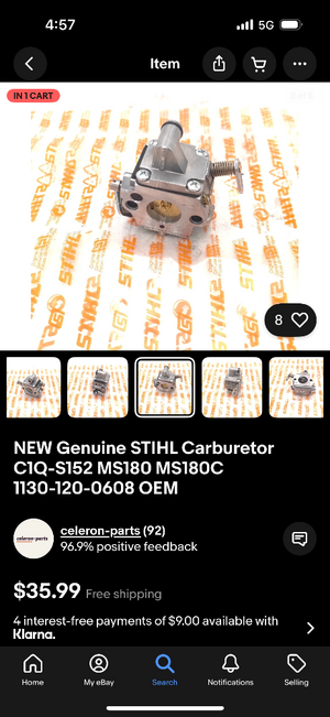

The impulse ports are in different locations from what I remember?
Your carb gasket might be blocking it.
25/250 left side ms 180 right. Think you need to slit gasket a little to make it pull vacuum correctly

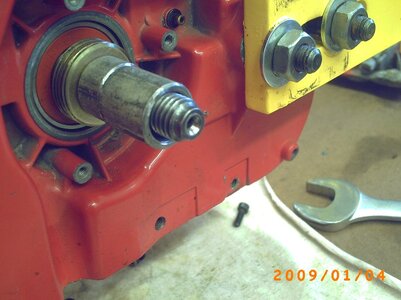

Andy (Lakeside53) had an excellent description of the process using home made tools etc, unfortunately the photos were lost in a hack long ago.
I try to use the threads on the crankshaft to pull the case halves back together, in this instance it was a Jonsereds 910 I believe. The washers and spacers push on the inner race of the bearing and the clutch nut applies the force needed.
