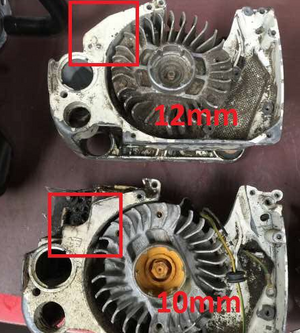

Thanks that helps. I don’t have enough threads on here to post a for sale ad so I’ll give it a try locally. What do I need to look for to know if it’s 10mm or 12? Just curious for future reference, I have another one that I’ll probably keep and wondered what size it was.

I'd be willing to bet there's pics and info on this forum regarding identifying 10 or 12 mm if I remember it's something to do with the case on fw side that u can see without taking anything apart

It is the one gos at a 45 degree angle by muffler on rewind side case half, the other one is dished out like a u shape. Not 100% but the 45 degree angle one is 10mm i think.

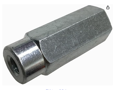

This is what you need right here, I have this set and it works great.
One trick an old machinist taught me is, install two grade 8 nuts and thread them down. Using two wrenches, tighten them into each other as much as you can. Now, use your wrench to turn just the bottom one to the left. The top nut will keep the bottom one from turning so that the whole stud will come out. Or it will break.
