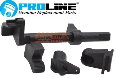

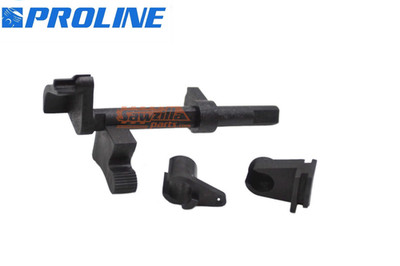

This is interesting - Proline is re-popping the 042/048 switch shafts now, which were almost impossible to find before:
Wonder if someone will start making the impossible to find pto bearing
