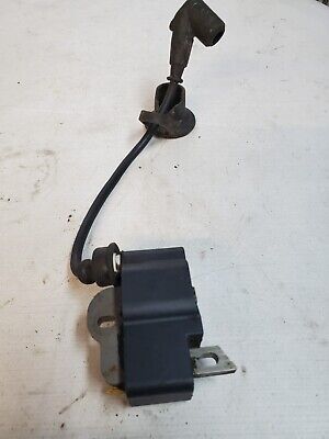

Well, found a used coil for cheap cheap on eBay. See if that fixes my problem, otherwise I'm going to have to go OEM, or switch it over to the 291 carb coil and flywheel that I have sitting in my boxel parts, would rather have mtronic though

This is what i got, the seller has another one with the harness and air guide/switch on it for $35, dont know if they would ship to maple leaf land though, might be an option.... then again no garuntee that it will work either, thats worth a $25 gamble to me... the coil retails for $145 here in NY... granted i get parts cheaper, but so far i have $10 invested in this saw aside from the coil thats on its way... so if i dont have to lay out oodles of money i wont....LOL
Also, full disclosure, going to be doing an experiment on this one, putting a 362 m tronic coil in a 261... cant see any reason it wouldnt work, coil mount is the same as far as i can see comparing my 362 and 261 coils, only reason i havent swapped coils that way because the 362 is not mtronic...

I see no reason why it wouldnt work, both mtronic carbs have the same harness, only difference is the secondary butterfly and smaller primary venturi on the 362, one would think it shouldnt have too different of a timing and fuelling map...

I’m going to guess the 362 coil won’t run quite right on the 261 but we’ll see I guess.
I’m thinking the timing and fuel map will be off enough where it won’t run well. No point in Stihl making two parts if one works for both. Also it probably will vary on what version mtronic it has for all of it to work together well. 261 mtronic version 1 and 2 have a different jet in carb vs version 3.
