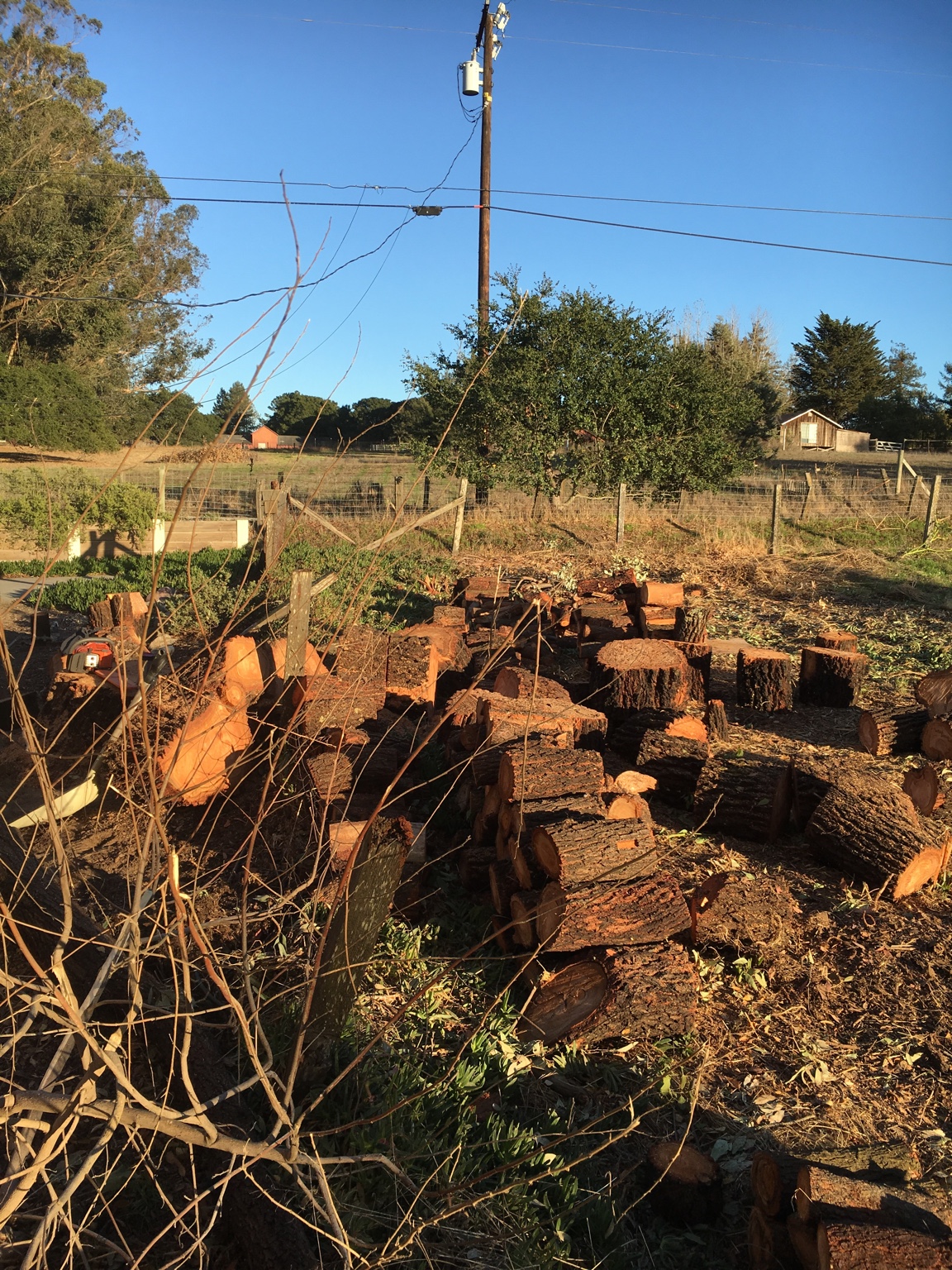

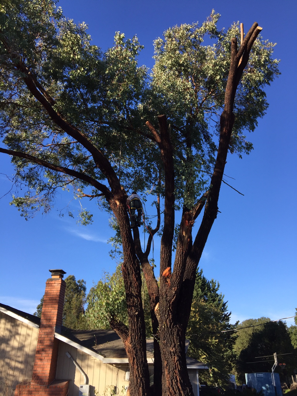

Hah! true,its pretty dry,tough country round here,with trees to match. Mainly Box and Ironbark eucalypts, growing in rocky clay soil.
Wacked 3 down beginning of the year, too close to house and after 3 years of drought, large branches were coming down
Hideous, heavy and havoc on chains
How would you rate the Iron Bark for weight and hardness compared to your usual local timbers?
That stuff is why I call a 70cc saw my little saw that I use to limb trees like this in Aus.
I have a ported 026 that rarely gets used.
