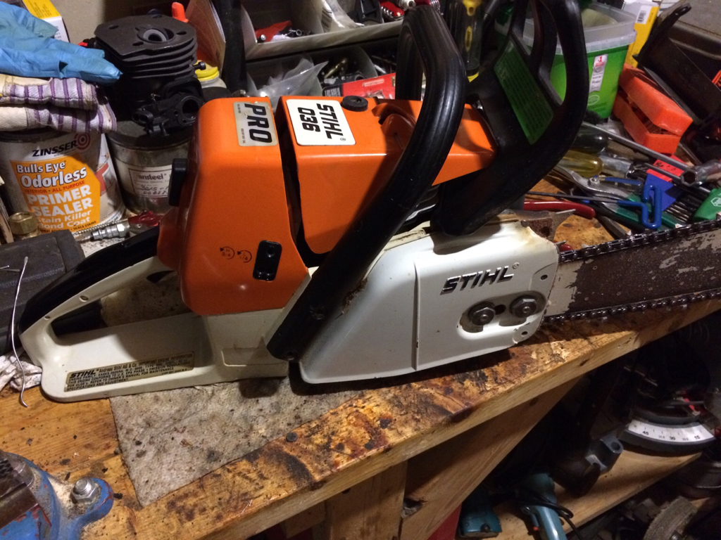

I recently acquired this 036 Pro with a lean seized piston and rings. New seals, piston and rings and now it runs great.
This saw had no cold weather shutter installed. Could the lack of a shutter in warm weather cause it to seize? I've only opened a shutter on one saw just because it was 5 below 0 F
when I was cutting.
Opinions or experiences?
Thanks!
when I was cutting.
Thanks!
the one on my 036 not pro is located just to the right of the spark plug.contrary to the manual saying it was located on the air cleaner box cover. nice looking saw BTW.
What I should have said is that my saw did NOT have the shutter installed to the right of the spark plug. I was wondering if you guys have come across 036's without the shutter installed. It seems that most of the used engine covers for this saw that I found on ebay did not have this shutter either.
Thinking that it could affect cooling of the motor in hot weather and cause it to run hot and seize.
part # for the shutter is 1125-084-4100. that shutter is primarily for letting in heated air into the carb during winter /cold weather . i would think not having it would affect the carb more than the engine when running in hot weather. but hey!! i'm just a firewood hack.

I've installed the shutter and it is in the closed position.
