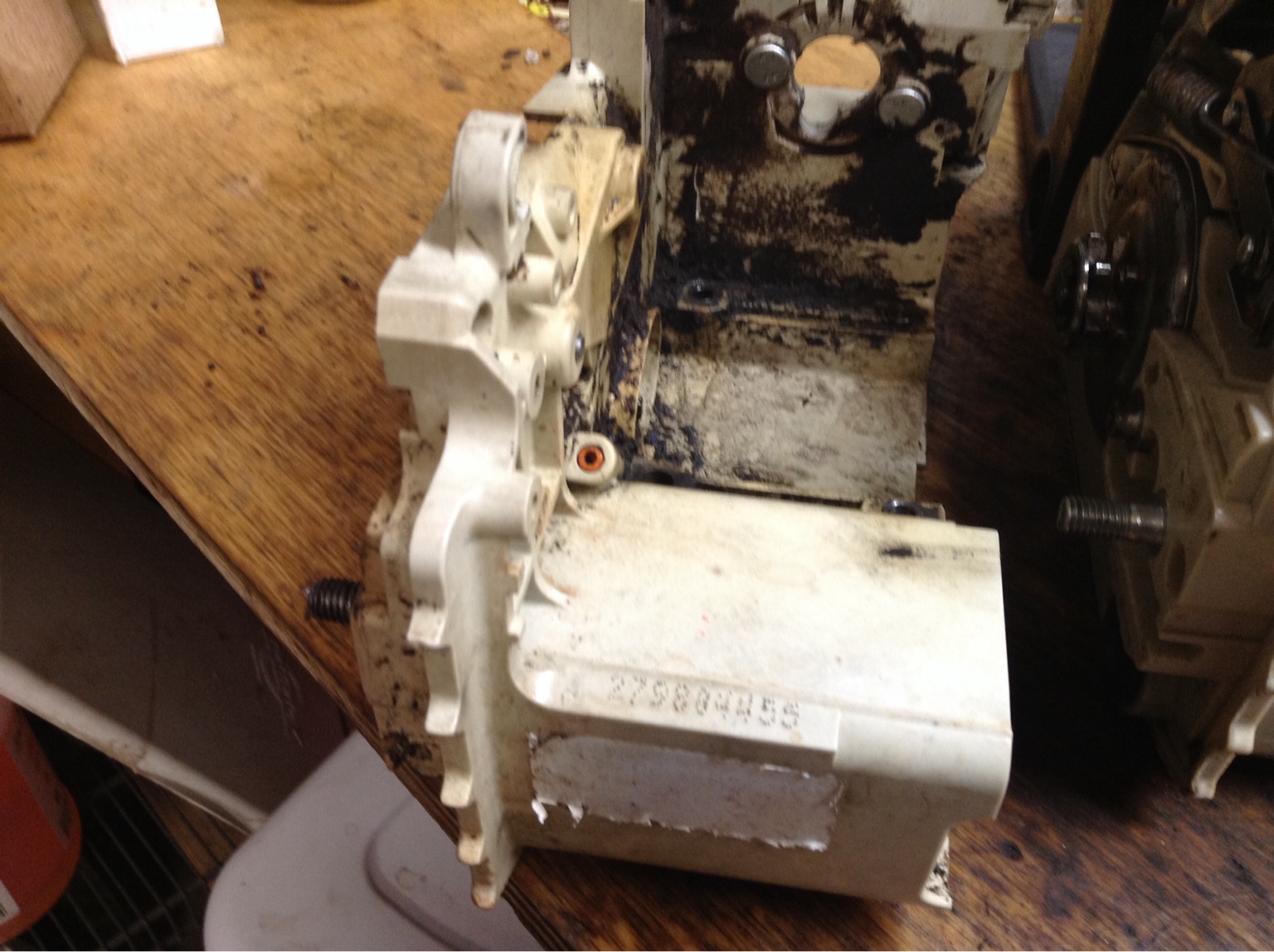

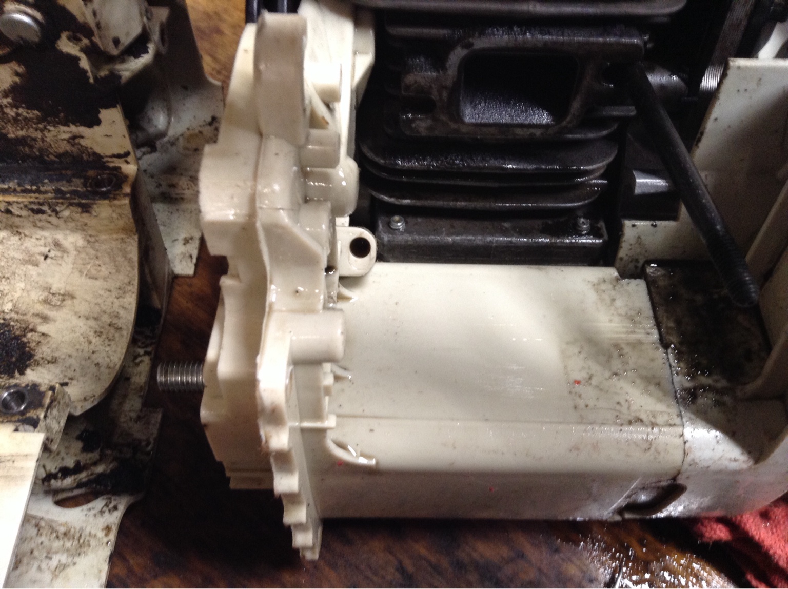

I am changing the case a on a ms170. The old case has this red plug and case has the hole with no plug and the oil pump pushing oil out of it. Mediacat doesn't show the plug so how do I get the one out of old case without tearing it up ?

Replace this plug with a grub screw, part no. 9134 381 1230. Coat the screw with a little bit of Dirko HT and screw it in. It will screw it`s own threads. Leave it out of the hole about 1/16" and you`re done.

Thanks, I turned down a wooden dowel and drove it in. I also had to drill the oil passage from the chain side in to the oil port from the pump on this Hutzl case as it liked a quarter inch being deep enough.
