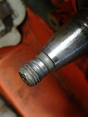

Well my problems continue with this 6100 ....
I bought a cheap aftermarket coil to try and low and behold it didn't make a difference BUT after taking the aftermarket one off and assembling back with the OEM I ran into another problem..
Tightened with a 3/8 air ratchet and pulled the threads of the crank 😭
Now I'm in for a crank replacement and still have what I'm fairly certain now is a carb problem.
Ernie
3:11 PM
14,984
59,741
Sorry to say this, but in my book that is now a parts saw. :(
If You can find another parts 6100 with a good crank & carb You can assemble one running saw and have some spare parts left.
This is why I do not undo threads on chainsaws unless I really have to.

Have one size smaller thread machined onto it and a custom nut made?
Would certainly take a skilled machinist to do it.

That conical seat for the flywheel doesn't look right, its surface should be smooth and not as pockmarked as yours.
To me it looks like the saw has been tampered with in the past. Could be the reason for messed up threads.
It's very possible it was ...
I purchased the saw with a lot of missing parts so I can't really be sure of its history.
Im to far into this saw rite now to just use it for parts .
I'm gonna find a good used crank and change it out ... probably a bad idea but just the way I am ..lol
