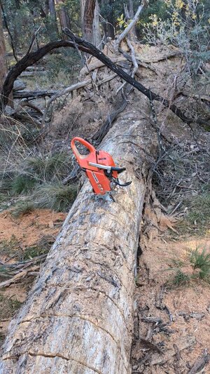

Thanks, I will order both and give it a birthday present
Might as well just add a pic of what it was doing on the weekend

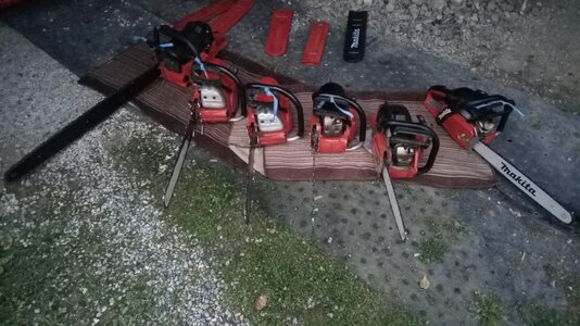

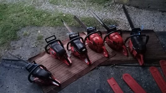

A portion of my girls are out for hopefully some gymnastics today PM after work.
PS-9010, PS-7900, PS-7300, PS-6100MMWS, PS-550, EA5000XS & Makita battery powered UC250D just for giggles - gonna pull her out of my car and say "I'm ready, lets go!". :p
Chains from 3/8"Picco to .325" over 3/8" way up to .404", as short as 40DL up to 156DL again for giggles. 😆
Log pile is supposed to be hornbeam.
I think I have temporarily doubled the value of my car. 😂
