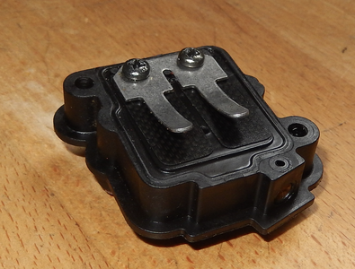

I've been trying to get this 3410 back in business, and am having some troubles...
First the carb was just dumping fuel into the intake, even after a deep cleaning. Got the needle height set so it doesn't seem to flood, but the saw will only start on full throttle, then rev up and die. I can feather the throttle to get some good blips off the saw, but it won't seem to idle one bit. The carb holds 10psi pressure (as long as the impulse port is plugged).
Maybe I set the needle too low? I've messed with the carb jets from 1/2 turn out, to ~2.5 turns, and it still won't start without full throttle.
Saw has a new fuel filter, and seems to have been tinkered with. The muffler was gutted, so maybe the previous owner also messed with the reed valves? I'm not familiar with diagnosing reed valve issues, so I'm dropping into the dolmar thread to get some input!

The reed valve is easy to verify: Once the carb is removed there are just two more screws to undo the intermediate flange holding the reeds:
The flaps must lay plain on the flange's surface and may not be buckled or dented. Also check the foam gasket between crank case and flange (removed in the foto above).
My guess for the culprit nevertheless is the carb. From my experience the 3410 is very sensitive to non-optimal functioning carbs. Have you put new diaphragms into it? If not, that should be your starter.
I appreciate your detailed answer!
Will be digging into the reed valve today, to get a better idea... It does sound carburetor related still, but it'll be nice to rule out the reed valves.
I was trying to avoid buying a $30 carb kit, but that'll probably come next.
Do you know at what height the needle lever is supposed to lie? I've set mine to be flush with the small ridges that surround the end of the lever, but maybe that's incorrect.

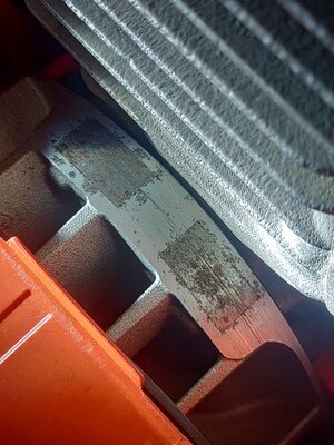

Edit: Looks like my reeds have a slight lift off their seat. The foam is showing a little wear but I'm not seeing any pieces missing
