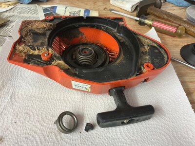

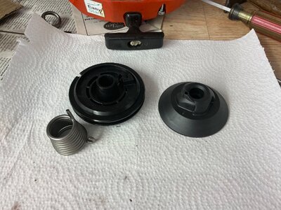

Easy Start 5105 kaput. New parts but unsure of how to tackle this. I envision the starter spring unwinding.IMG_0012.jpegIMG_0014.jpeg
