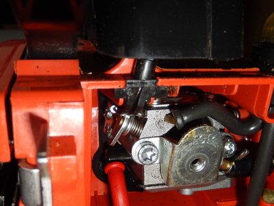

Can anyone with a 3410, take a pic of the throttle linkage for the carburetor? I've been fiddling with it for way too long, and can't seem to figure it out...
Thanks in advance!
Thanks in advance!
Looks like my saw is missing the 'redirect' component... Now I'm a bit stumped if I can get this thing running without it!

Does this help?
As you can see the cable goes down thru the grommet which is part of the cable assembly. Below the grommet it's bent backwards and hooks into the carb's throttle-lever.
Thank you, friend! I am missing the grommet entirely, but was able to source one for $10 from someone selling a 3410 case on the 'bay.
