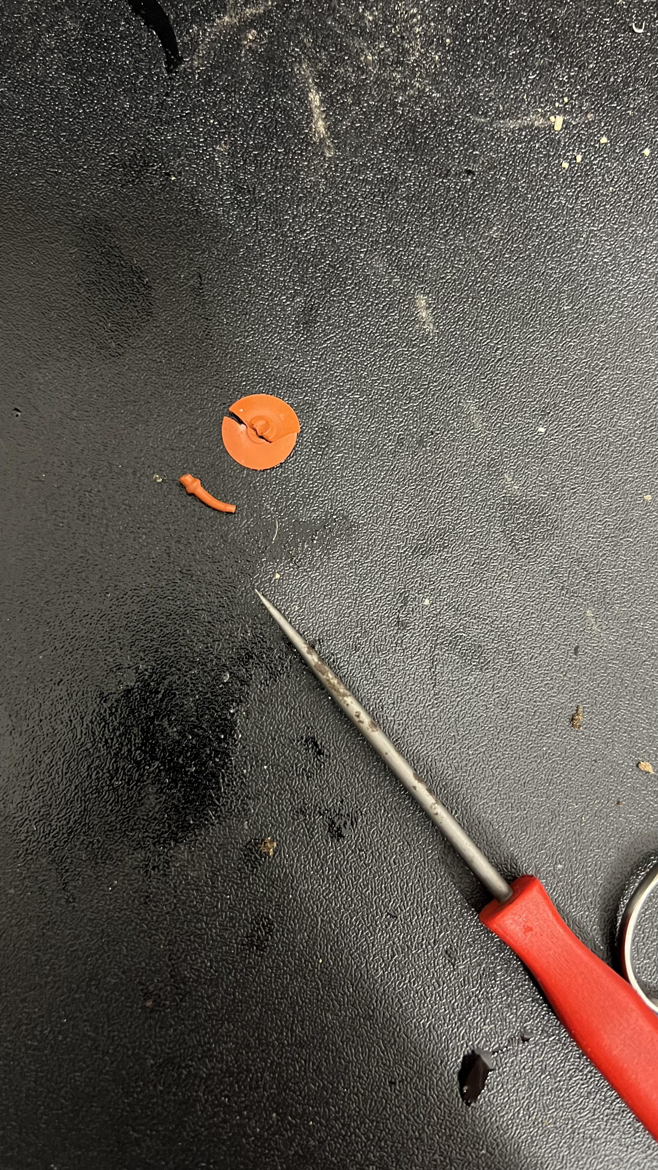

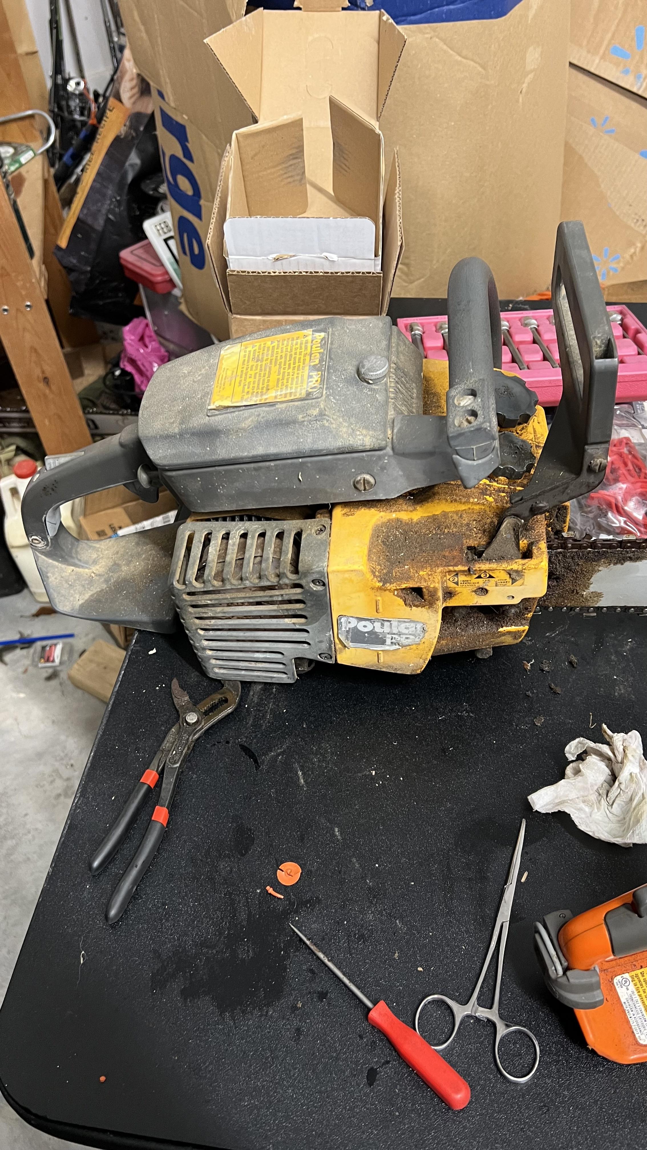

Hey fellas, I picked up an old PP P40 and I’m looking for the little rubbers that go in the fuel and oil caps. Anyone know where I might get some? Thanks for any help!
Do you have a picture of the saw? It might help in identifying the parts you need. I definitely don't know all the Poulan saws but I have never seen a Poulan P40. Maybe a Pioneer P40?

I’m sure it is a P40 Pioneer, but pics will absolutely help. Last pic shows the little rubber piece I need.
Thats the same check valve used in Holley carburetors,(accelerator pump) O'Reilly should have them in their high performance section.

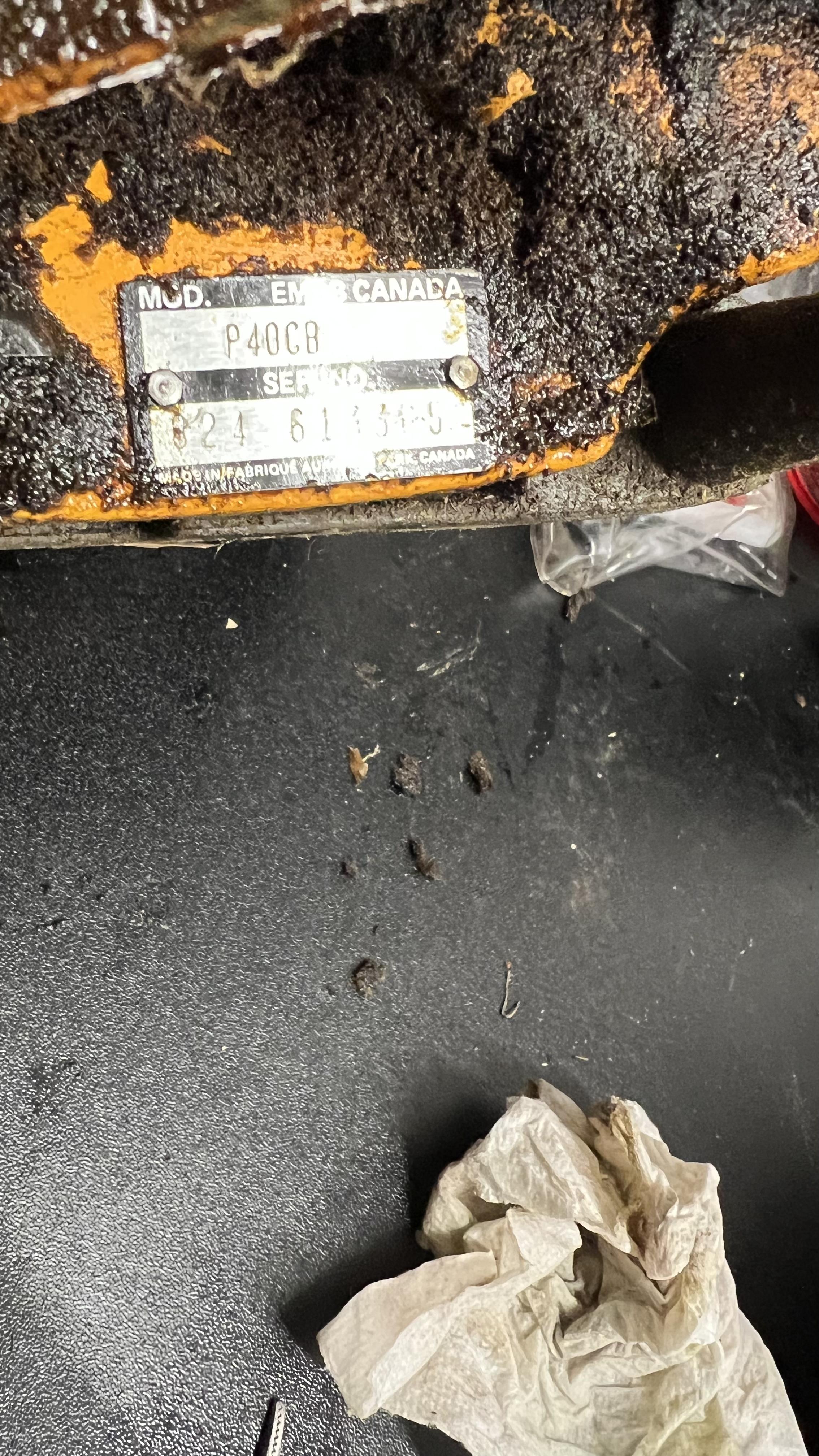

That's a weird one . It looks like a P39 Plus.
Maybe when they moved production to Huron Park they got the labels messed up.
You might check the Stihl check valves for an 036 1110 353 1600.
If you want to measure the ones you have for diameter of the valve and length of the tail I can check one on my 036 to see if they are the same.
