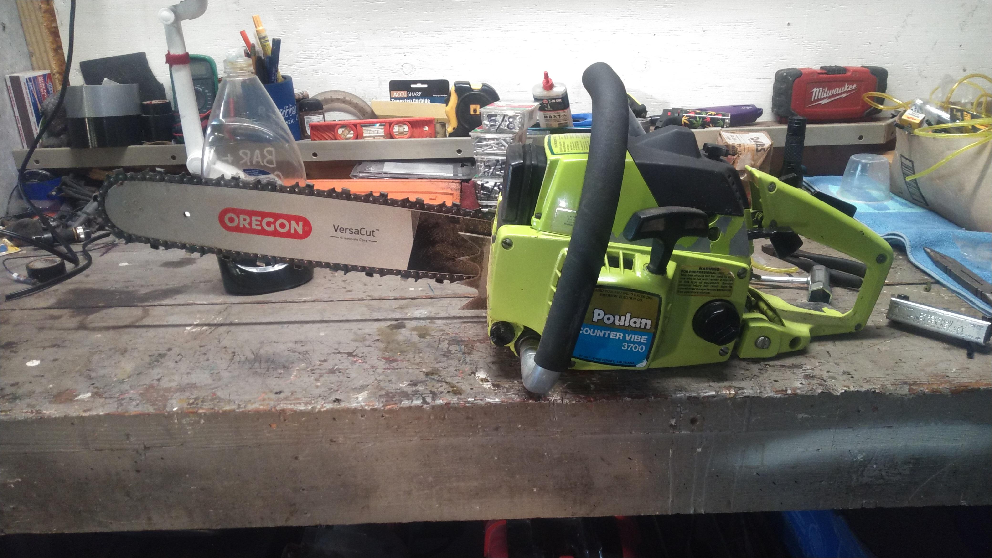

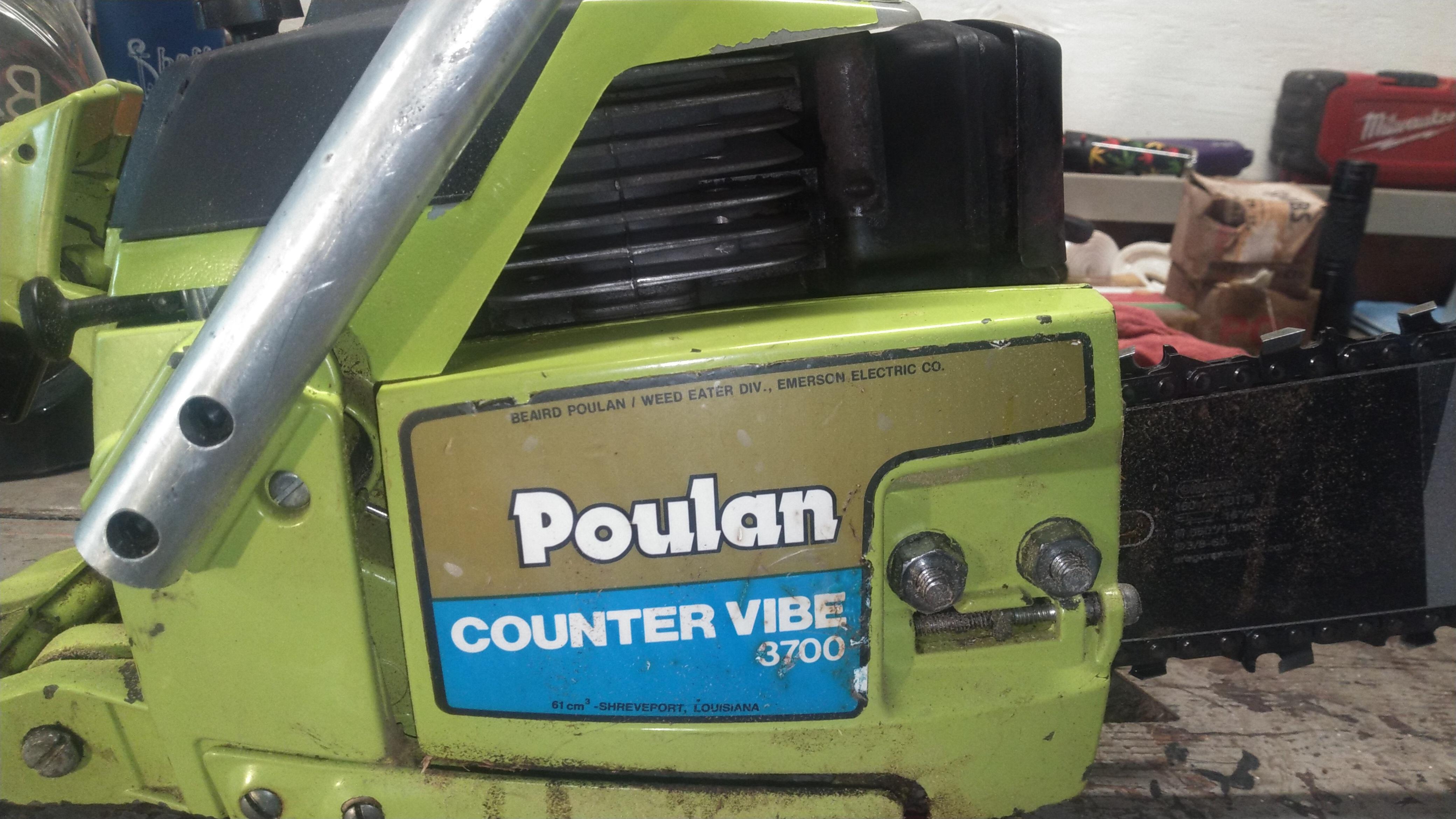

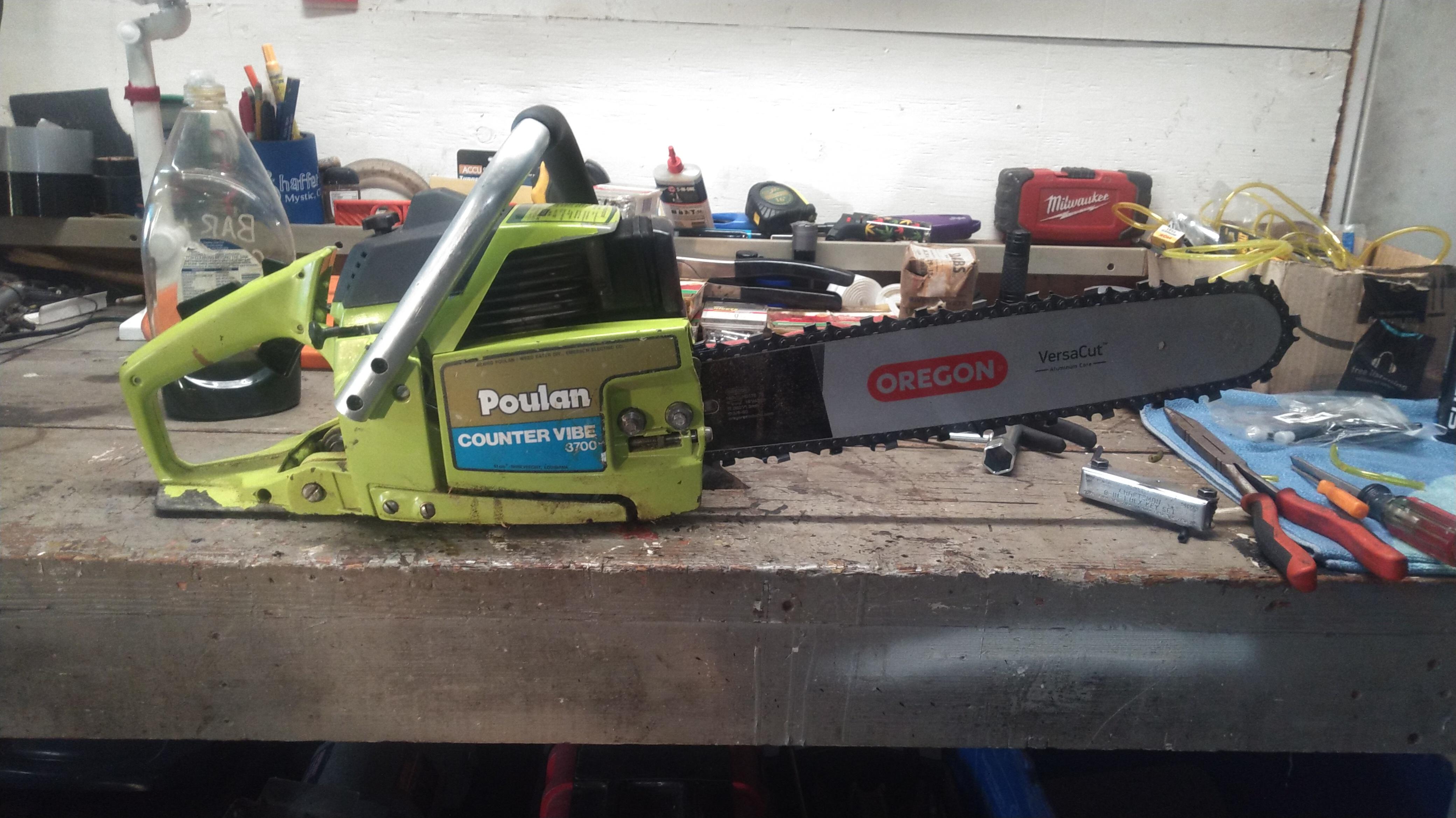

Just saved this one. Needed a metering diaphragm and gasket, fuel line and filter, tank vent fitting and vent line. Have it setup 16". Real screamer.
Very nice!
Muffler looks like it was a VERY low use saw.
Just spotted one the other day, but the guy wont sell it...yet. He also had a 4000 that looked to be complete.
Also wont sell that one...yet.
Currently doing a motor swap for a 2000 for a co worker. It was his grandfathers saw, and was absolutely used to death.
That is as it should be. Thats what they were made for.
I did manage to find a VERY low use donor to do a motor swap though.
Hasnt even run long enough to rust the muffler.
Got the carb in soaking. Fuel line has been replaced, and I think the tank vent will hold up.
Have some "gently used" carb diaphragms to go back in it.
Should be a runner. I'll include pics then.
I look at these pics and am genuinely sad that American marques don't make saws like this anymore.
