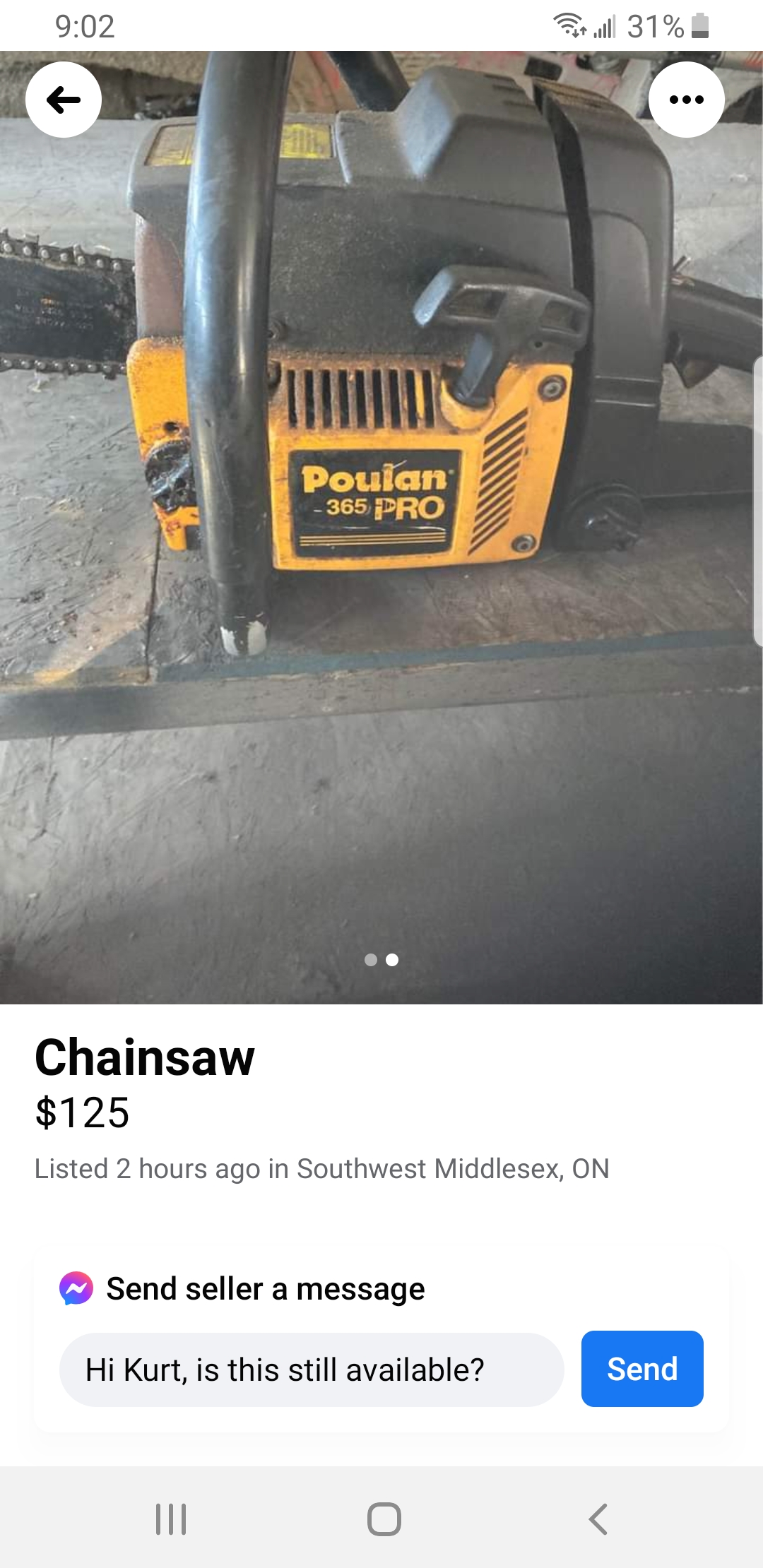

Whats your thoughts on this pulan. Were they any good? Specs say 60 cc.

I have the 54 cc version which is a 336. It's a great saw. I figure the 365 wouldn't disappoint.
Maybe if you buy it you can bring it to the GTG in Aug Randy.

Ya for sure. I got a busy week this week but might find time to see about it lol.
Be a nice addition i think.
