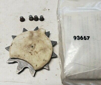

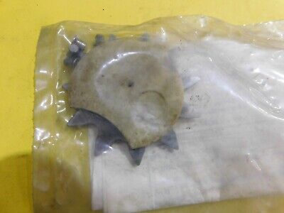

I looked at the 86854 11 tooth sprocket kits that I have and they are all 6 rivet.
There is a 93667 kit with 4 rivets but I don't have any.
Between Chainsawr and eBay there do seem to be some 93667 replacement sprockets available but you have to consider the cost of the parts, your time, effort, and aggravation, and the overall condition of your bar before you decide to invest in repairs.

Thanks Mark! I ended up going with chainsawr because they were the best price,even with their ridiculous shipping charges.All totaled it was less than $14
