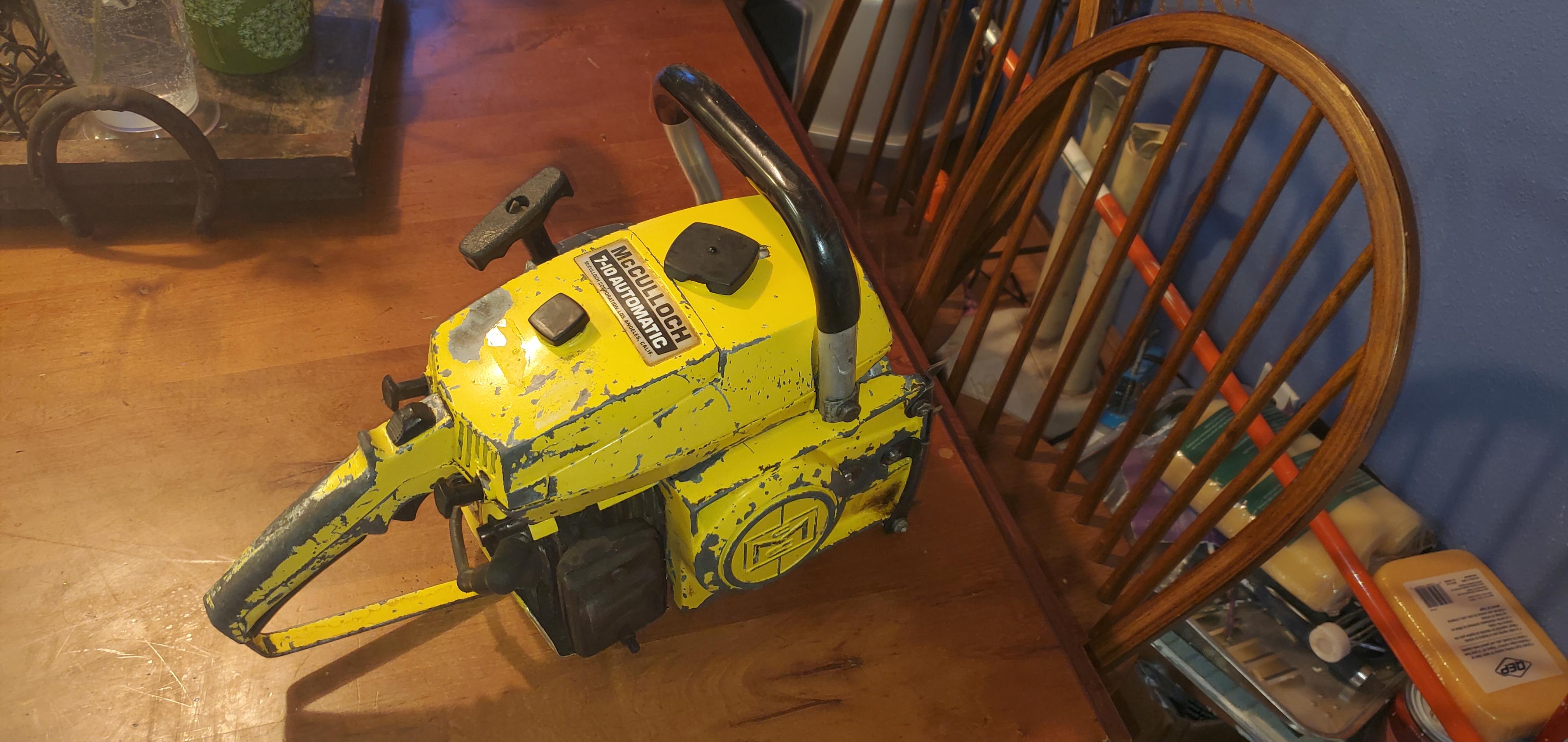

I picked up a 10-10 auto yesterday. fairly clean saw overall. Will take a closer look next week. Initially only item noticed was the muffler had some extra restriction reduction.
I was given a paper IPL, but could use any other manuals available. I believe it is a 1968.

link to the Standard MAC repair manual for the 10 series saws. Too large to attach. The link is to a cloud storage site.
https://app.box.com/s/alfhsyc2d1dprwat0b8191csbe8q8z4o
