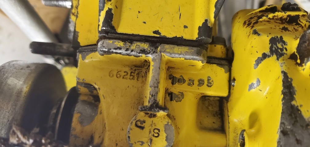

Need a little help identifying this saw. I'm 95% sure it's at least a 797 but could also be a super 797. Model number on the underside of the crankcase is 66251. Underneath the serial number there is also 13 and a couple letters stamped in. A couple unique features are the cp directional muffler, the larger tillotson hl103 carb and there is also a boost port cover. I measured the bore at 2.28 inches.

Thanks Mark, some good info! Love learning about all the variations. With McCulloch it seems like there's no shortage of that! However, their lack of decision making when it comes to color schemes actually makes for a bit of fun.
