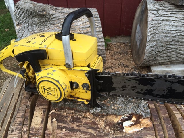

67L36Driver
8:24 AM
596
9,674
41,654
Very nice! I've never seen the recoil on the clutch side of a saw before... Very cool!
10-10's don't get any plainer than this.
