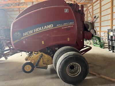

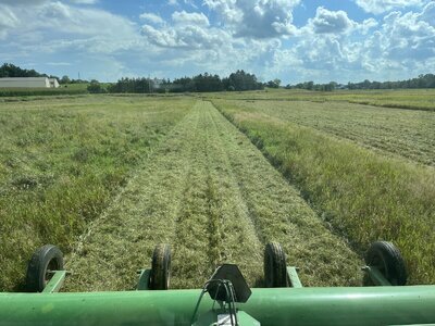

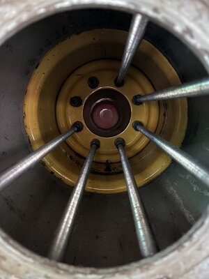

In preparation for some soggy meadow baling coming up I put the duals on the round baler. Not so much to keep the baler from falling away but to keep the pickup open far enough to keep it from closing up and plugging.

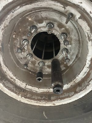

I found some bolts with threaded heads that were made for this purpose on the interwebs and some threaded rod from Grainger and duals were born.
I had to build a super deep socket to get the nuts tightenable on the new dual rods. It was rather fun cutting a brand new SnapOn socket in half lol

Never seen a baker with duals on it. You folks must be getting plenty of rain up yonder.

Never seen a baler with duals on it. You folks must be getting plenty of rain up yonder.
I don’t know of anyone else with duals on a round baler with big tires like mine. It’s know a few guys with older balers that had smaller 11l’s that dualed them up.
I had the duals on my 8575 square baler for doing meadows and kept them when I sold it. That thing was literally 3x heavier than my round baler. In parts of our meadows when I close the door on the baler the ground shakes and jiggles for 20’ in every direction around me. If you fall in you best stop RIGHT NOW and get something hooked on to assist pulling you out as well as something for the tires to climb up on to as you get pulled out. It’s nuts.

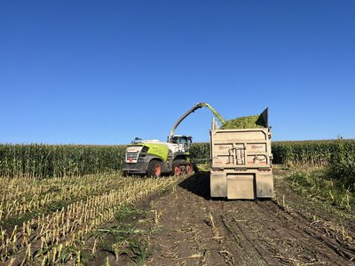

A large dairy nearby was starting silage harvest so I naturally wandered over to watch. And bum a ride in the chopper. And a few of the trucks with guys I knew. And the packer tractor lol.

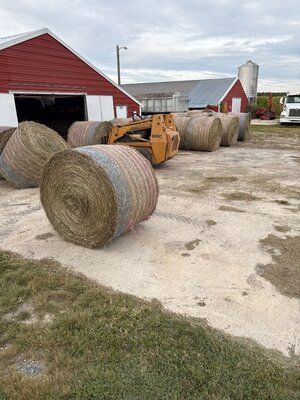

All dualed up and ready for battle !!

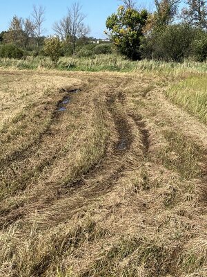

Big ol’ windrows in a drier part of the meadow. I didn’t get any good action shots of the soggy areas because I needed to focus a bit lol
This spot I just about planted it all in the deep muddy abyss. It really doesn’t look bad but I was losing power and almost flipped the baler off when the tractor popped back up and found solid ground.

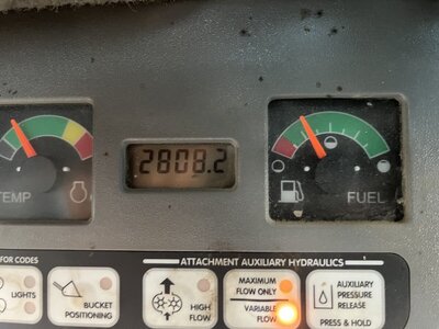

I like when numbers do this.
