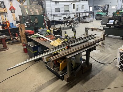

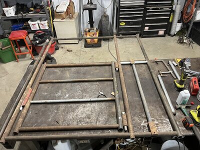

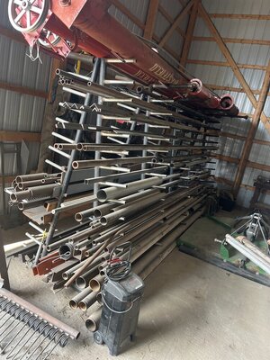

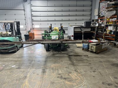

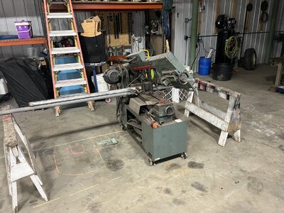

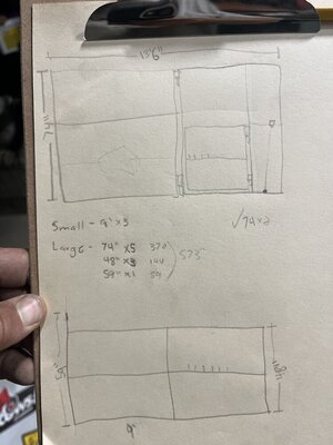

Good thing I have a healthy selection of gate materials. Buying scrap piles at auctions has its benefits.
Pick out a few good looking pipes and em bring into the shop.
When you build them yourself you can do whatever you want. Pretty excited to see how it turns out !!
Chomp chomp.
One is done and leaning on the camper. Two more are in the table. We built a calf mover box and it’s in the background along with Miss Lily rolling around in a new shop chair lol

Wouldn’t mind seeing the finished project so I can steal your blueprints 😂

I’ll happily share whatever you want once it’s installed and proven working. Hopefully that is tomorrow or the next day. I want the calves moved before the weekend. One of them is large enough to dang near walk away with the hutch he’s currently in lol.

Pretty work! Your scrap auctions are better than what we see, mostly bent conduit, a little galv water pipe and some chain link fencing posts. Tube, flat stock and angle are usually posted on craigs list, etc, and scooped up at near retail price...go figure...
Very nice shop as well!

I think I paid $275 for the steel rack and around $250 for every piece of iron on it other than the limb saw under it and the augers on top of it. Can’t argue with that.
Mocked the busy gate up before making it more permanent with the electric hot glue gun.
This is how they’ll meet up. The hole on the left will get a headlock pipe so I can catch the critters easier. There will be a feed through panel to the right of the panel with the little gate.
Little gate opened into chute position. Should work well as long as no one else runs out of the newly made opening. The long gate will get crib panel welded to it to keep them from climbing through.

You cut your hinges at an angle to make the gate self closing or am I seeing something wrong? When I get back to working on my corral I'm planning to make a few spring latches so I can just slam the gate closed and have it latched.

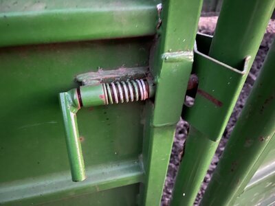

The hope is self closing. It’ll need a spring latch to be truly self closing. I may build a latch like the one on my tub if I have time.

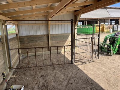

Gates for the first pen are installed !! I needed the lawnmower and loader to hold them in place lol. Heavy buggers.
They fold flat against the walls just like I hoped they would !! I don’t plan to winter calves in here so I’ll likely fill this thing up in the winter with the only thing that makes sense. Totes of firewood for next year !!
Calves have been installed along with a feeder and water tub. The boys were picking on Miss Annie the heifer cross so I stuck her back in her hutch until her side gates are done.

Very well done.
