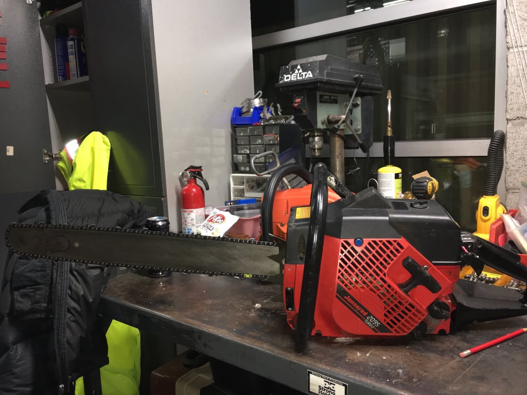

Picked up this 036 Steel (AKA) Shihl for $5.00 out of a pile of junk saws a while back while looking for my Hybrid 2156/2159 donor saws.
Had low compression, pulled muffler cylinder & piston to inspect & where in nice condition except for a very small scuff line on intake side.
Looked like the beginning signs of being strait gassed.
Drained & replaced with fresh Mix.
Put some honing oil in the cylinder to give back some compression. Pulled to till the ripcord snapped.
Replaced cord & began pulling till it started.
(Seemed like a 100 times)
Held full throttle.
With a little tuning and 4 tanks run thru her now it's a strong runner & earning its Keep.
