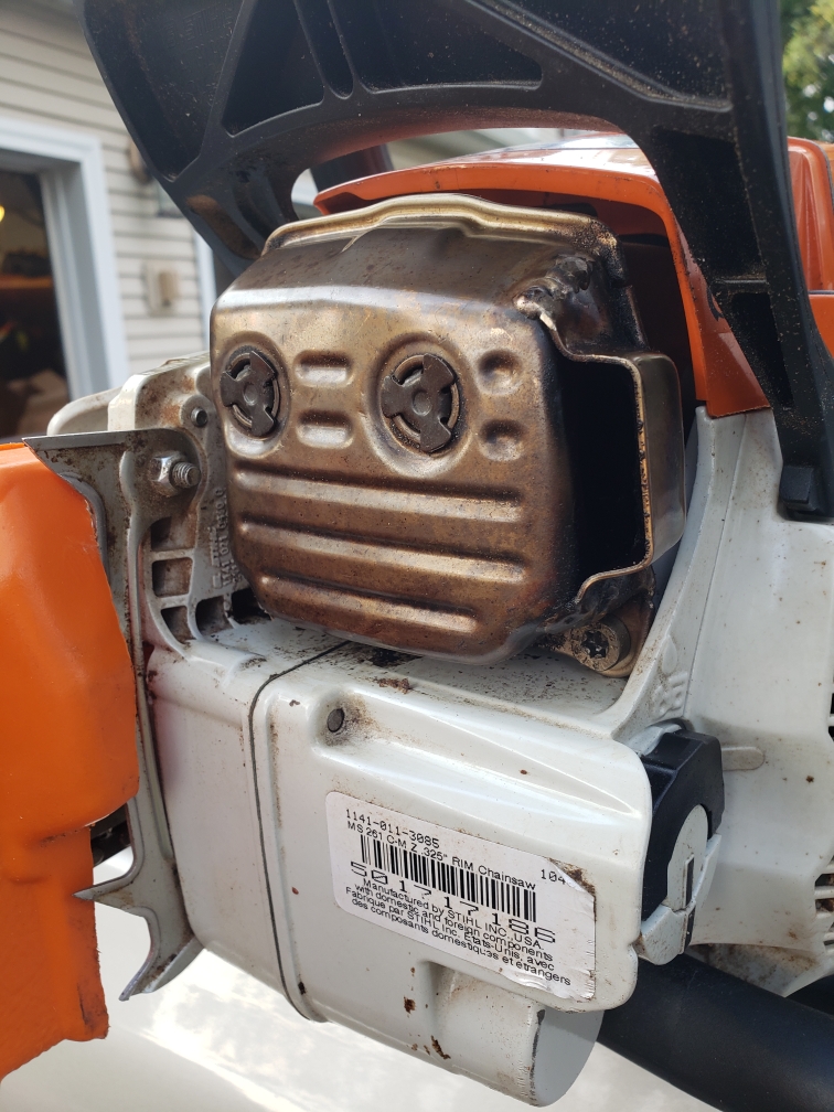

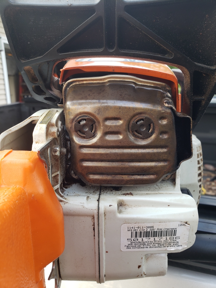

I guys
I have made my 261cm muffler mod
Tig weld
Time cut original muffler 7 seconds
Time cut muffler mod 5 seconds
In same conditions and wood
Now I am going to chearch how to send you pics

Pics ;)

Stainless in tough to weld...
Nice job @Joseph
Thanks RI
But i can say that it's very difficult to weld it.
The stainless steel of the stihl muffler is thin... very thin
I have made a muffler mod on a 661CM
I will post on the forum one time that I have test it

The stainless on these are a pita to weld but it’s much easier if you use .030 stainless mig wire as filler rather than normal 1/16” tig rods. Clean metal and an overly pointy tungsten helps too.
Riv-nuts ftw though.
Sorry but I leave in France and we talk in metric unit .
I have try with 0.8 mm mig wire and it is to thin for me.
I have try with 1mm tungsten, 15 to 20 amp of dc courant and it wasn't good
I would like to find 1mm or 1.5 mm tig rod but in France it is very hard
I perhaps have find a solution with brazing with tig welder and silicon bronze ( cusi3) tig rods.
Waiting to found it and wil try
mr mastermind May help us perhaps?
I use rivet nuts and button head fasteners rather than welding to the thin stainless material.

Is there anything inside to gut? I can't remember...lol
