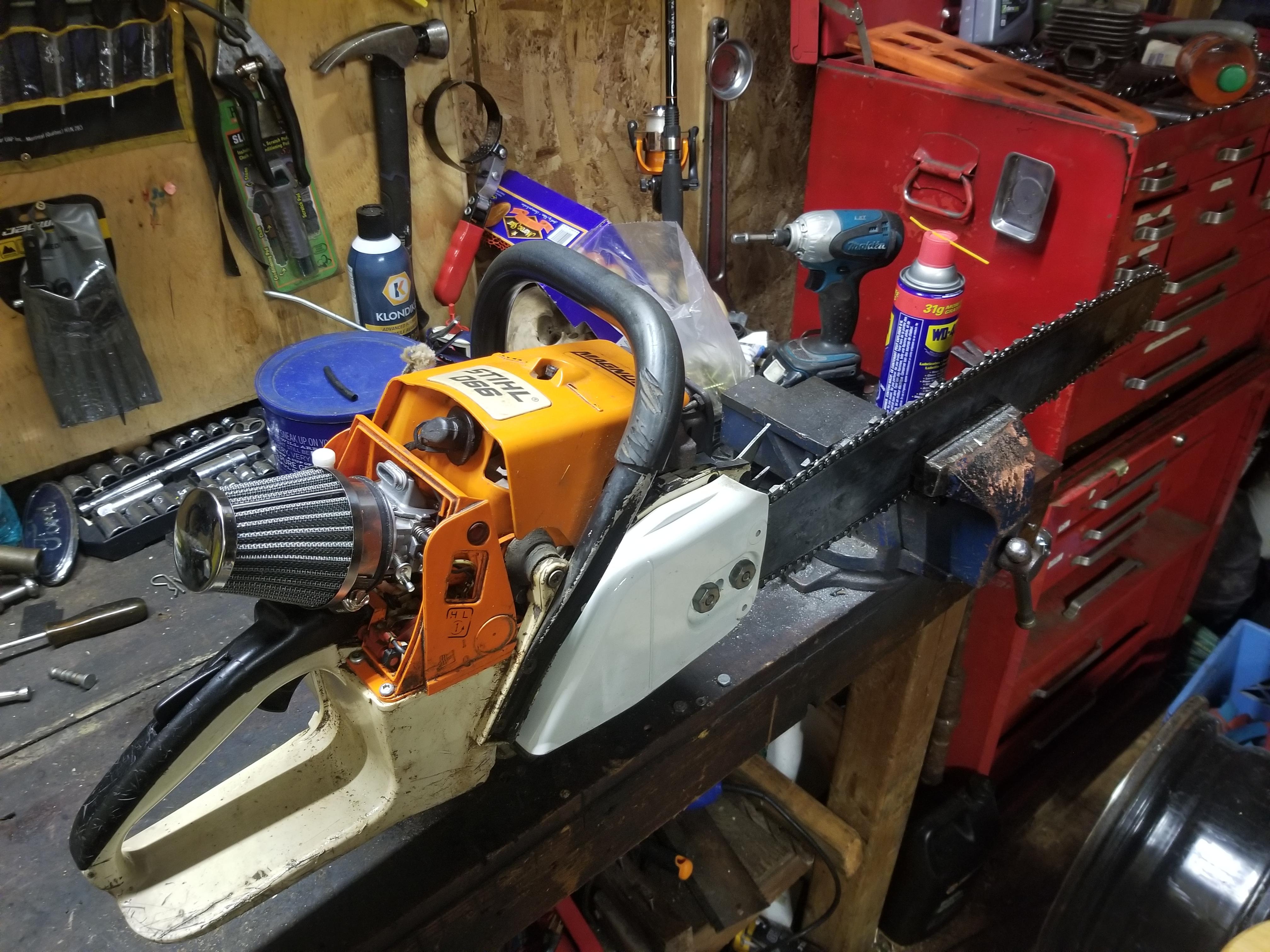

She aint very pretty. Heres my 066. Im getting the bugs worked out of it. I need to find a good used carb for it one day.

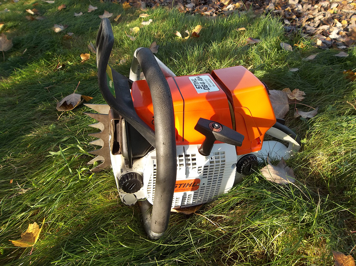

A couple of the nice 064s/066s I've put together over the years - this 064 was a real sweetie and went to an AS member, who sent it in to one of our builders for mods:
I spent two years sourcing parts for it, including a NOS starter and a cherry full-wrap style brake handle. It had a new old stock WJ-48 carb.
Slick saw! The 064 is a strong saw! A friend of mine has one.
