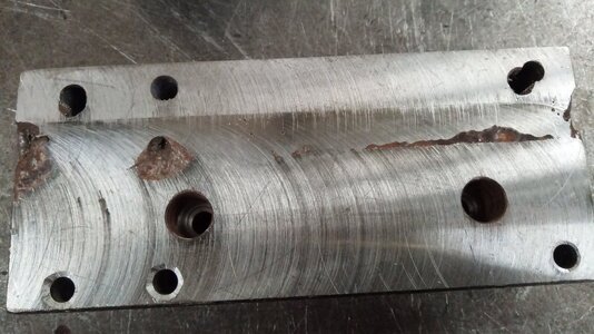

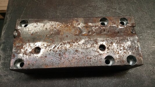

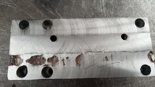

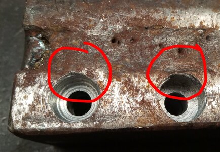

Making a new clamping aid, the steel stock I had was not wide enough so I stick welded two together.
I did not expect the stick weld to be hard enough to deflect the countersink and chip the tip of my Solid-Carbide drill bit.
I have a feeling it'll be fun milling the block flat and the workpiece seating holes into it.
Drilling & tapping clamping threads will surely also be interesting.
9:54 PM
14,985
59,761
I just needed to get the surfaces flat and parallel, milling out the welds is not needed for the intended purpose.

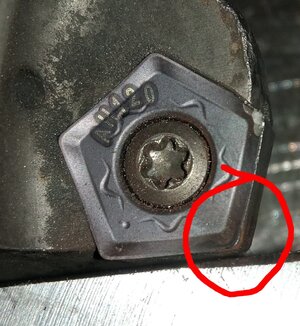

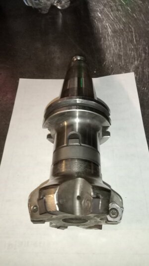

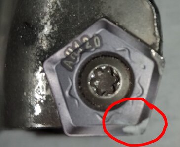

6 insert mill head, one insert chipped the other 5 are showing mild wear.
As suspected, the welds are damaging the tooling.

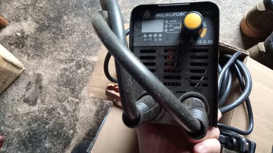

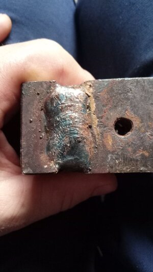

To be expected, good penetration on a thick metal weld is always super hard.

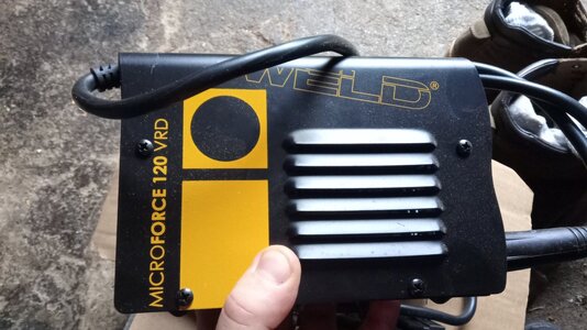

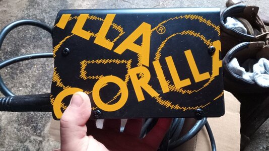

I think my tiny iWeld MicroForce 120 VRD "Gorilla" did great melting a 3+ decades old 3.25mm basic coated electrode.
This little welder was 80€ out the door with a 2 year warranty.
That weld puddle is over a 1/2" wide.

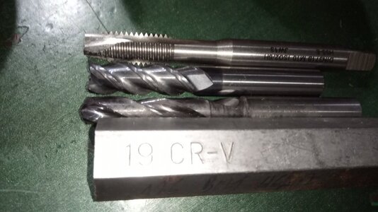

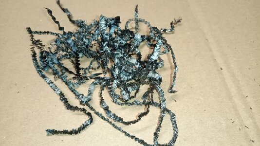

I worked a 19mm CR-V allen wrench piece today.
Milling the end flat with a Solid-Carbide 10mm end mill, and drilling the hole with a 8.5mm Solid-Carbide drill bit was a piece of cake.
But the M10x1.5 machine tap nearly seized in the workpiece, luckily I knew this was going to happen so I only gave it 1mm cutting depth at a time and stopped when it began to scream.
HSS/HSS-Co is a good affordable all rounder, but certain applications require more expensive & specialized tooling.
I will try and get that thread a little bit deeper with a 3-step tap set, I just wanted a straight thread start anyway.

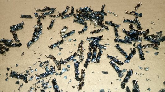

Plunge feed milling w/o chip breaking
Drilling with chip breaking

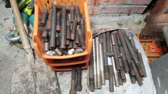

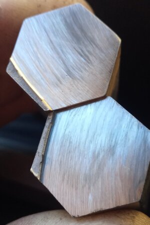

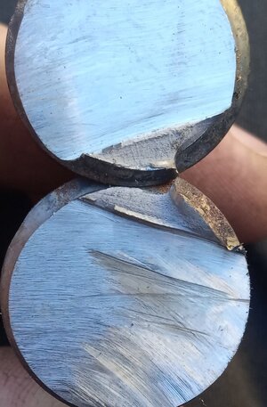

19mm Allen wrench CR-V, snapped w/o prior deformation.
Very fine structure, nearly clean break.
24mm 12.9 grade bolt, shoved minor deformation before breaking.
Notably coarser structure, quite uneven breakage surface.
I like messing with metals, highly alloyed steel in particular. :thumbsup:

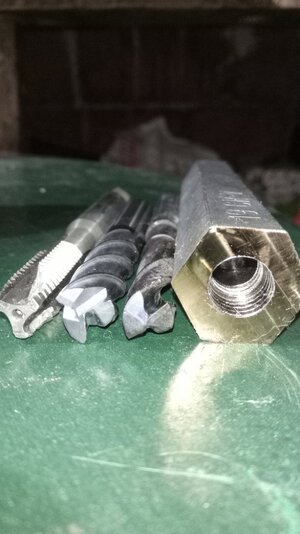

I couldn't get the CR-V Allen wrench cutoff threaded so I tried tempering it.
It helped, I got a M10x1.5 thread about 30mm deep into it.
The first 10mm are drilled out to 10.0mm to serve as a pilot hole.
It is a strong firm thread and it only took several tries.
I think you meant to say annealed it. Heat it up, hold it for a bit, and then let cool very slowly to remove and hardening.
I may not have used the metallurgy professions/industries correct term, though I believe I did write it properly.
I dry processed a highly alloyed tooling steel, CR-V.
The milled & drilled surfaces took on a blue coloring indicating high heat.
I believe I quenched/hardened the drilled hole what kept me from cutting a thread into it.
I heated it up and let it cool down slowly to temper the quench.

I Googled annealing, it is a similar process.
I will settle with both of us being right! :beer-toast1:
