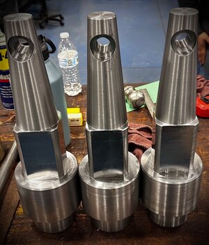

That is some pretty work!
Thank You very much! :beer-toast1:

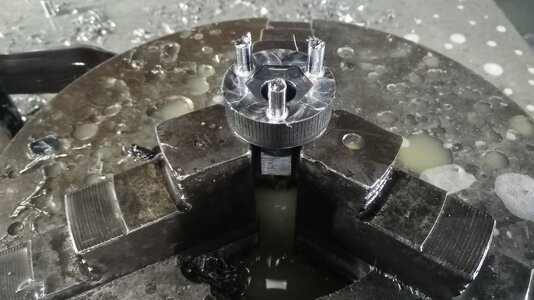

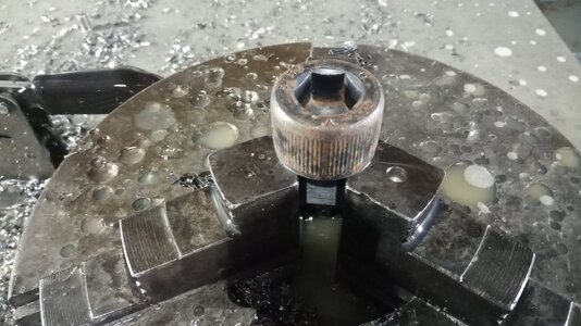

A fair amount of time, effort & $$$ went into making them.
I have made 5 different clutch removal tools, 3 for Husqvarna and 2 for Dolmar/Makita.

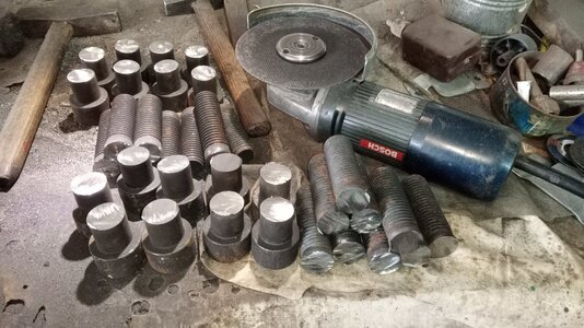

A much better result than the sockets that I have hacked up with my angle-grinder!

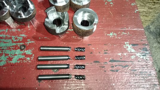

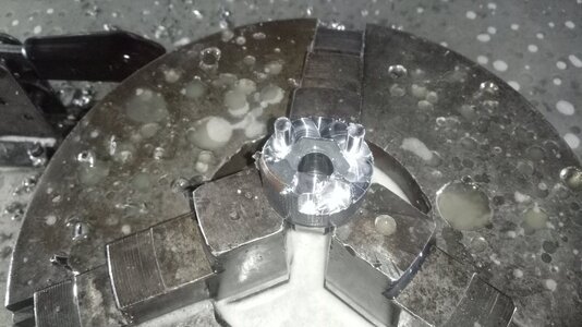

My custom made ones are challenging Solid-Carbide end mills, and clamping vices.
I had to swap out the broken mill bit and redo this one.

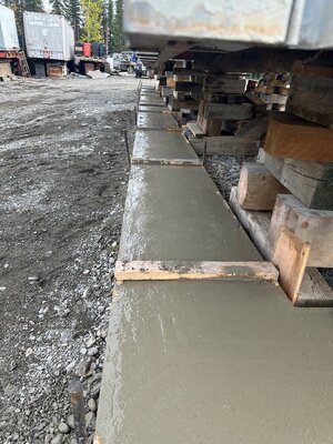

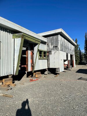

I agree I live my life doing that
These are made of metal and I salvaged them to build a shop out of them.
Footings are done next year they will be sitting on them and reroofed

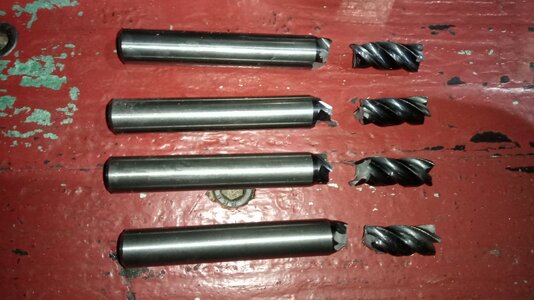

This wasn't funny. :confused:
Called it quits after the fourth 7.0mm end mill committed suicide.
It is a proven milling program, I used it over a dozen times with no issues regarding tooling choice, feeds & speeds.
Come to think of it, maybe I had a bad collet causing out of round. 🤔
P.S./Edit:
A 10.0mm end mill processed the top & ID, no issues.
