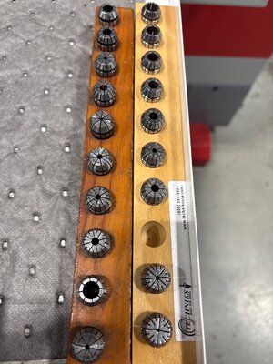

Yes , the collets will work for all ur diameter applications,
12:11 AM
14,985
59,761
ER11 & ER16 collets clamp down by 1.0mm from specified clamping OD, though You should stay shy at no more than 0.9mm.
ER32 collets will also clamp down by 1.0mm from spec, and they'll do so firmly.
That been said look into buying collets in 1.0mm steps and You should be able to cover a very wide range of tooling OD.
There are special collets for taps, but the standard ones work just as well.
The tap collets have a square hole in their bottom section, better clamping force and can save on having to length index the tap.

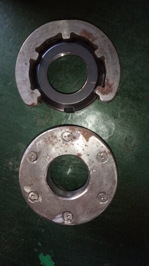

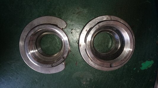

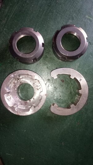

Don't forget to acquire fitting collet holder nut keys!
It took my workplace over half a decade to buy keys for every collet holder size & nut we have in use.
12:11 AM
14,985
59,761
At one point we had no ER32 key at work, for a couple months, for 18 mills, hundreds of tool holders.
I began making my own custom ones, they are only missing a lever to be welded on.
Company finally did get a new key, so I took my creations home.
Mine are covering more nut grooves than the OEM ones do (OEM slides into 4 grooves), they are also much more beefy.
Maybe one day they will see some usage, probably not at my current workplace though.

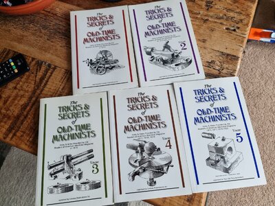

Here is link to a great free book that you will find interesting: Machine Shop Trade Secrets by James Harvey. You can read it online for free or download it for free in various formats. Did I mention that it's free?
It has lots of tips and tricks about machining, tooling, making things, working faster and more efficiently, and solving problems. It is fairly modern too and includes info on CNC machining.

Thanks! Definitely a great resource!
I was going to skim a bit just to get a feel for it, and wound up reading the first chapter in its entirety.
I bought a bunch of used books as well. I'm starting with "Machining for Hobbyists" to get a relatively quick general overview, but I love reading the "tips and tricks" compilations. I have volume 1 of "The Machinist's Bedtime Reader" in the bathroom, and volume 2 next to my bed.

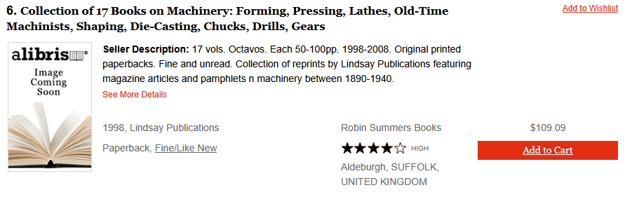

I bagged this set on eBay a while back. Some of the info is obsolete or unsafe, but there are some really good tips too.
I'm glad the school is paying for the tools, because I am working towards being book poor!

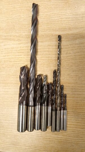

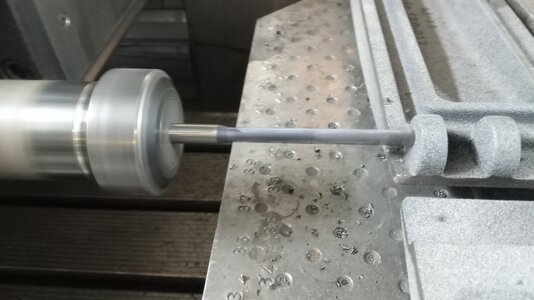

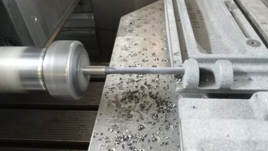

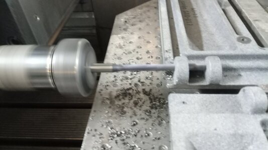

HSS tooling certainly has its place in machining, but Solid-Carbide does nearly everything - better, faster, longer.
A Solid-Carbide drill bit is much more rigid than a identical OD HSS/HSS-Co drill bit.
It will drill into nearly any material without needing a pilot hole, whilst a HSS drill bit can and will wander without one.
The only true issue with implementing Solid-Carbide tooling is the price, the longer and larger they get the higher the retail price climbs.
Second from the left is a 1/2" bit.
I'd say get a supply of both HSS & Solid-Carbide to see what works best for Your application.
When restocking tooling You simply leave out what is not being used.

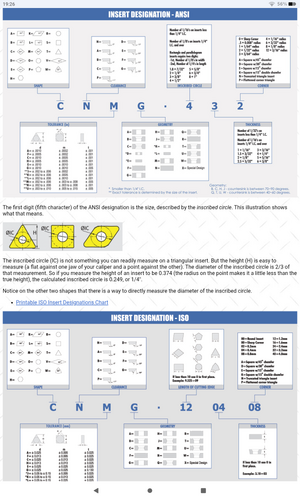

'Hobby' machines are fine with small, sharp, positive rake, small nose radius inserts like CCMT. They do not run well with any larger, blunt, negative rake, large nose inserts.
Here is a chart that shows the insert ID system:
Your machines are larger than the small hobby ones, so they should be able to run the bigger, industrial inserts.
Look for bundles of used tooling and job lots of mixed inserts on eBay. You can get a large amount of tooling for little money. And you can cherry-pick the holders and inserts that suit your machines and sell the bigger stuff on.
