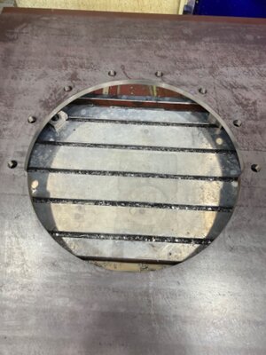

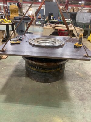

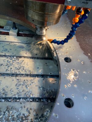

Making part for a fixture to hold a final drive. Has a 28 3/4 inch diameter hole. Had to bore 1/2 of the hole at a time, plate is 59 5/8 square, 1 inch thick. Bolt holes are for a M30 bolt.
Got it finished today.

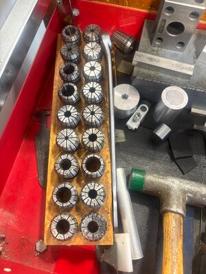

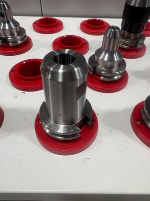

More questions...
I have never run a mill of any size, and I'm trying to sort out tool holders. I didn't realize that it was so complicated!
The milling machine will likely be used by a number of people for a number of different things, so flexibility is the main goal.
The taper of the spindle is NT40. Looking over the options, we definitely need a drill chuck (precision keyless), and I was thinking perhaps a Weldon holder (or holders) and an ER collet holder would give the flexibility we need? Any advice on this would be greatly appreciated.
It also seems more difficult to find NT40 tools. My understanding is that the threads for the drawbar are different Does anyone have any recommendations? Glacern seems to have a good selection for NT40, but I have read that the customer service can be an issue. I took a quick look at the MariTool site, but I didn't see NT40...it looks like they specialize in CNC tools?
Ideally I'd like to get the vise from the same vendor as the holders.
Again, I'm grateful for any and all advice.

My vote goes to ER collet holders!
Will give You a wide range of cylindrical shaft tool clamping compatibility and You don't need to buy tapered tools.

Thanks! Do you think that it would be helpful to get a limited range of Weldon holders as well, or just add them along the way as they are needed?

I use a combination of ER and Solid holders, the Solid holders are best for rigidity machining,

Yes, Weldon is a good option.
I forgot about those.
At work we utilize collet vs. Weldon at a 100:1 ratio, as such it slipped my mind.
You will find Weldon holders practical only when You machine with tooling over 16mm OD.
We have them for ~1+" drills with replaceable cutters (23.0mm and up), and for a couple 25.0mm end mills with replaceable cutters.
Collets can cover a fair range of tooling diameters.

Get different size & length collet holders!
Not sure about Your machines, but we use ER32/70 for 50+% of our tooling, but there is requirement for ER32/160 , rarely ER32/200.
Also for clearance reasons ER11/150 and ER16/150.
ER11 collets will clamp up to 7.0mm
ER16 collets will clamp up to 10.0mm
ER32 collets will clamp up to 20.0mm
We also have two ER40/160 tool holders, but I don't know their clamping limit.
Also, out of ballance throw is lower with solid/Weldon holders.
You may prefer them for milling.
Though quality brand collets are fairly accurate too.
