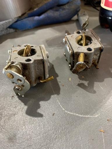

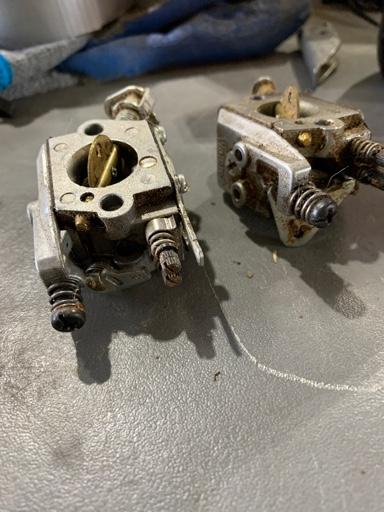

Well... besides being a deep subject, I did manage to get the purple people eater saw running yesterday, although not well. The idle screw was jacked way forward causing a high idle, (another sign of a forced death) once that was corrected, was impossible to tune to run correctly. A new carbeltater will have to be acquired, good news they are back available, now to just get it in time...
hoskvarna
8:02 PM
376
10,648
60,610
Iowa
I have 2 of them Steve
Which one ya need
Sent from Hoskey hilltop
