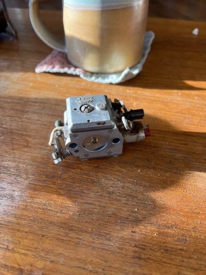

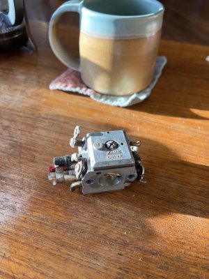

Zama EL42 off a 346xp (NE). Afraid I don’t have a Walbro, but the configuration of inlets and needles are the same. Husqvarna and Poulan went under the same parent company some time around the turn of the century, so both drew parts from the same factories. If I remember right, the choke and kill switch assembly is the same or very similar.

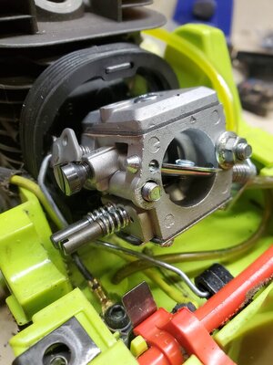

ended up going with the HDA-12 as it looked to be the closest and its pretty close to drop in. plastic choke lever is gonna need heated and bent a little but I think it should work. took out the throttle plate and soldered the hole in it shut so I can control the idle speed better. had to rotate the fuel barb around but I think that's about it.
she's coming alone.

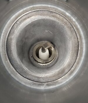

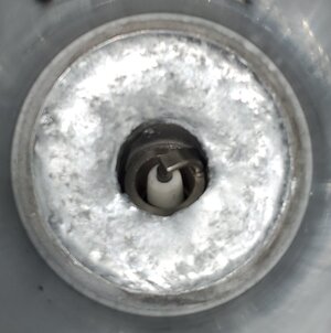

I'm curious what the compression will end up at. Here are some pictures on the top on the cylinder right after I brazed it.20230206_223733.jpg
