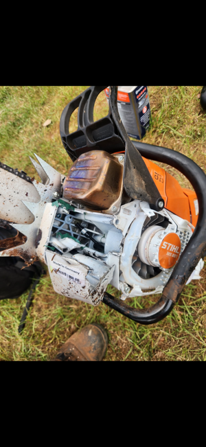

Of the saws my tree guy has, they all do except for the 592xp so far. The MS 201TC's elastostart handle is the first thing to go, then the pull chord, constantly changing them, otherwise work well until pawls and pulley are worn enough to jam it up upon attempting to start. The 372xpxt/390xp's are good for the occasional starter chord, the pulleys are sneaky and wait until they are plum worn out and come in contact with the pawls while running, then blow up to take out the air foil, coil wiring and pawls, maybe even the starter housing depending on the level of shrapnel.

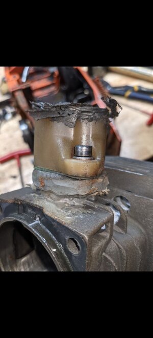

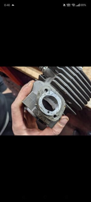

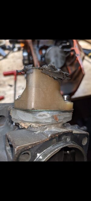

Some of my favorites are when people break things more than necessary by first breaking it and then using incorrect parts to repair it.
One of the more memorable ones was when a 394 came in and a guy tried to make a 395 cylinder work on it with the 394 intake tract. I give him an A for effort.Screenshot_2025-11-16-06-46-35-39_965bbf4d18d205f782c6b8409c5773a4.jpgScreenshot_2025-11-16-06-46-12-74_965bbf4d18d205f782c6b8409c5773a4.jpgScreenshot_2025-11-16-06-46-09-97_965bbf4d18d205f782c6b8409c5773a4.jpg
