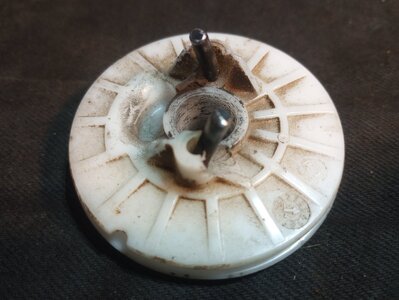

Since they've been out here my tree work professionals, loggers and firewood guru's amateur and pro alike, been using them pretty much without falter for the most part, some exceptions besides the smashed handles, clutch covers and whatever else they manage to mangle up dropping trees on 'em and whatnot are starter pulley's, this being the one reoccurring failure I continually see is the starter pulley's break when a young fella full of beans just grabs it without the use of the decompression valve and gives a yank as hard as he can from free spool right into engaging the pawls, which breaks the posts on the pulley. This does not happen if you engage the pawls first then pull. That said a new beefed-up pulley has been made, getting your hands on one is a different story altogether, let alone the old style.

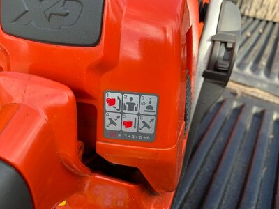

It has been the opposite for my 550. Failure to start at ambient temperatures of -22 (-8 on the German scale). MS460 arctic would not start either, yet I grabbed the 30 year old Dolmar 6000i and it started on the 3rd pull with the fuel injection choke. Here is the pictograph on the 2017 550 with hot restart issue steps listed at the bottom.IMG_0033.jpeg

Im guilty of grabbing the saw and yanking the pull cord, I think I will change my method to giving it light force until I feel the starter engage than give it the tug it needs to fire off. Thanks for that info.

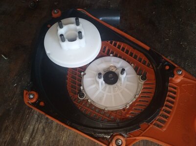

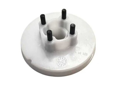

It's a lot easier on the pawls for sure and a good practice,but the 572xp pulley is the same part as in a 562xp and the 550xp. It really should have had its own design in my opinion and not need to be babied to keep from breaking. Hopefully the new replacement will work its way into the system more and more and be less troublesome. You will know it right off, as it has four engagement studs instead of two. I guess they figure it will spread the work load out and if nothing else have a working set if one pair fails.
Thanks for posting! Is there a production date, after which all the 572s have the four stud starter?

As far as I can tell, any problems with early versions of the 572XP, have been addressed by Husqvarna. I have one on the way, and was a little concerned about the potential starter problem. Searching for OEM replacement starter assembly, results in out of stock. Aftermarket ones are available at half price. All the ones I found were two stud, but I didn't spend much time. Searching the part# provided by Woodwater, gleaned a few positive results, easily found. On a lark, I called my local F&F store, they had one on hand. While I was doing this, Randy sent me a pic, my saw has the four stud starter! Not saying this isn't still an issue, but it should be a diminishing one.
