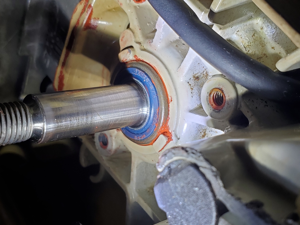

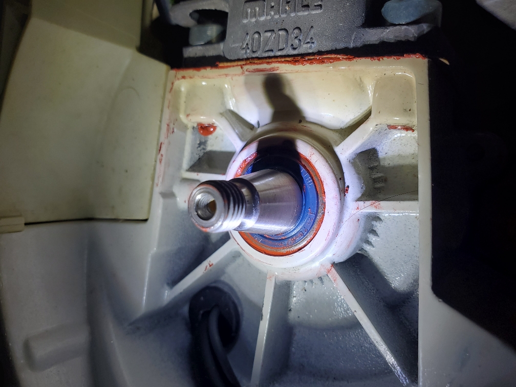

Tough call. Very common to have a "little" play in any that have some time on them. Without knowing the history of the saw...I would swap them out...

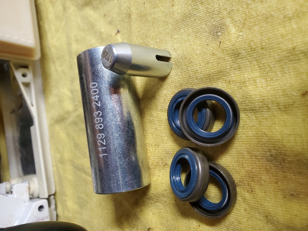

@PA Dan has had good luck using 026 bearings/seals in them instead of the funky bakelite seals. Lateral movement is always present. It's a loosey goosey bottom end

Bearings are rollers and they are easy to replace. The 026 seal is they way to go in my opinion! They go in great and I have had no issues. Case sealed up and held vac and pressure for days! I have 4 or 5 tanks on my rebuild and it runs perfect.

the whole thing comes apart real easy without any "case" tools. replace the bearings and seals and maybe the rings while yer there and be dones wif it...its worth the money invested. they are great saws that hold value well. if ya wanna borrow the seal tools Dan pic'd above PM me. Ill send them. Gonna need a IO360 case with yellow tags sent in trade :)
