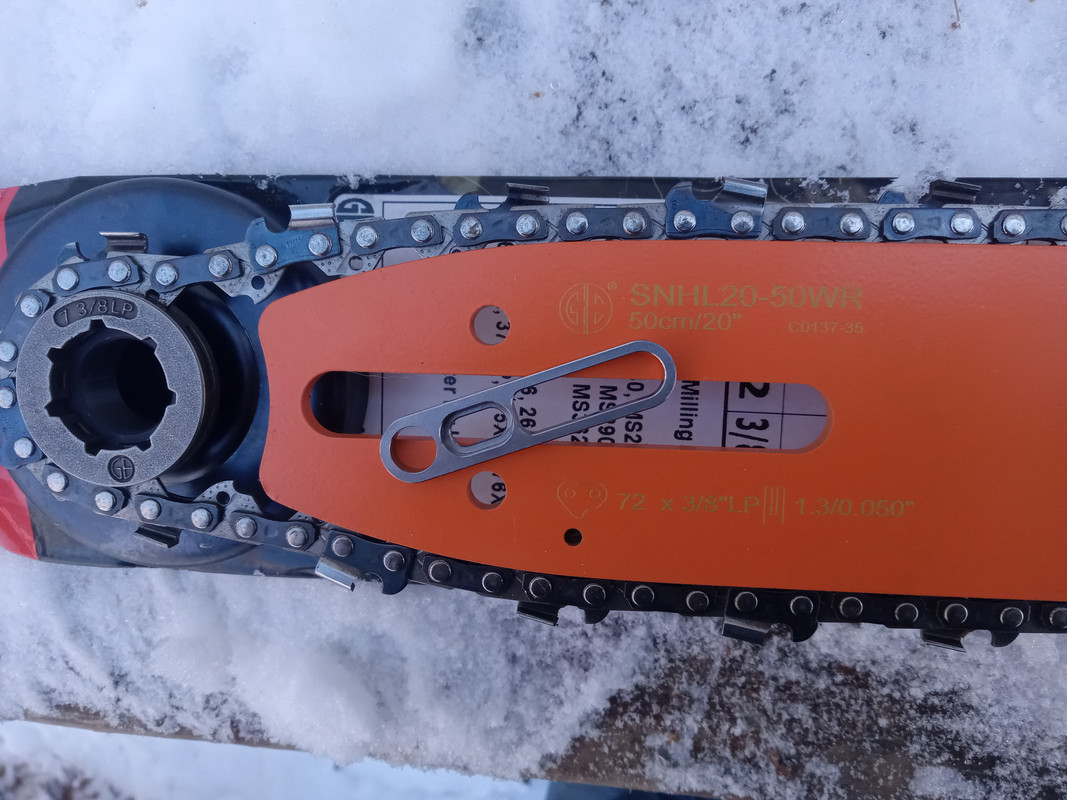

I've done years of milling with a 90 cc saw. They work ok in softwood, but fall flat on their face in hardwood using 3/8 ripping chain.
stihl 3/8 low profile pmx ripping chain, a gb 3/8 lp rim sprocket and a gb 3/8 low profile milling bar really helps the smaller powerheads chug through hardwood.
For a very versatile but easy to handle 90 cc set-up, the 27 inch alaskan mill frame will fit a 36" ripping bar. Then you wont have a bunch of rail hanging off the end of the mill.
Less kerf, more teeth using the pmx low-profile chain; rather than resorting to standard 3/8 skip. Your ripping chain will stay sharp.

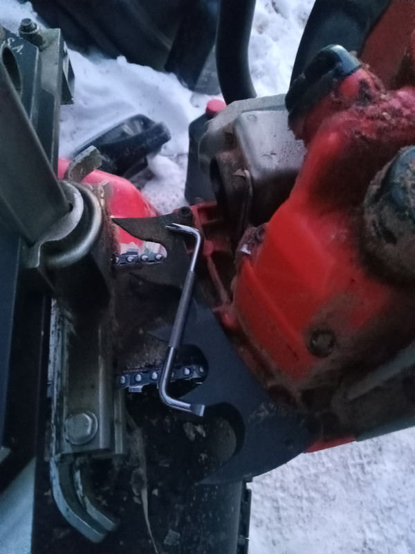

I'm currently using a 395, and I like it for regular cutting but I can't when it's tied up on the mill. Also, the 395 chain tensioner is a real pain in the neck. It's bad enough when not in the mill, but when in the mill, it's just about impossible to get to.
Front tensioners aren't a problem. Think outside the scrench........
