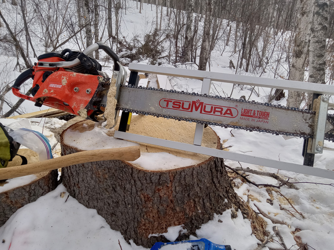

mainer_in_ak
9:46 AM
22880
Mar 13, 2022
958
4,097
Interior Alaska
IH,
Some saws were simply born to mill. No changes required. The seller is a well respected, awesome guy on any forum he's a member of. If u want to be a weirdo, he does a have a ported "milling recipe" which is very speedy on 18 ft ripcuts. Fkn thing over-oils 42" bars. Don't miss my 881 mag or my 3120:
