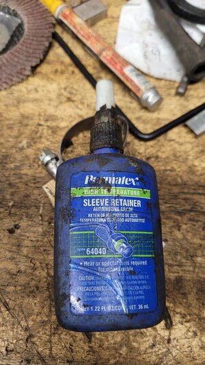

440 crank is actually smaller diameter than 361. There may be seals out there that fit the difference but I just made some brass bushings. Kind of like the top hat on a 372.
View attachment 417807View attachment 417808View attachment 417809
Looking back thru at the build, with the bog, i would double check that your crank sleeves are still in place...i dont see any mention of retaining compound, and maybe a double check of seal diameter tolerances? The bog kinda sounds like an air leak a bit, i might be wrong though...
You might be on to something…
With the bog, and the excess heat, my opinion is that you’re also running a bit lean. Whether it’s an air leak, or just the carb tune.
That’s the Green Mayonnaise.
The bushings aren’t perfect but I checked pressure/vac many times. I certainly will again. Hopefully I can fiddle more today. The chain is not dull, but a little raker adjustment might be the ticket.
Gotcha...LOL i am used to seeing it in the bottle, not a mayo jar 🤣17169868403004888049861816827139.jpg

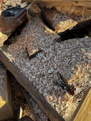

Plug
Chips
Juice?
I cut some more today. It cuts strong but not fast. The saw started with the idle all wrong, so maybe there is a leak. I think my oiler is junk and maybe the exhaust should go up. I haven’t done a pressure test but that needs done. Working up to a list of things to do when I open it back up.
1:26 PM
352,761
Plug
Chips
Juice?
What are the port timing numbers? And have you put a timing light on it to check ignition timing?
