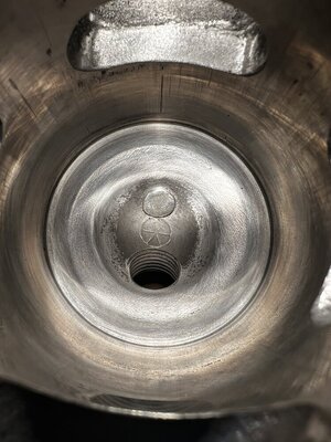

Found some things I don’t like.
I think the FT mesh filter is headed for the trash. It lets a lot of fines through.
And this wash pattern is pretty disappointing. The uppers opened at dead on the same time, but I think there was a hump in the roof of the PTO side.
But they’re dead flat now. 77/100/121
I also relieved the chamber substantially.

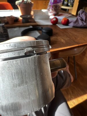

Not much more to see really.
If you look close, the ring deformed the roof of the port as well.
This is a first for me. I’ve seen hung rings, but never had it happen to a saw I messed with. I’m not sure why it happened. The floor of the exhaust was stock. I did a very light chamfer, but otherwise it was factory. This jug had been scored before I got it. Some of the scoring was in that area and there was a minor spot just below the lip of the port that was too deep to sand away. I disassembled, raised the ports, radiused the chamber and reassembled in about 4 hours yesterday. It’s possible I got funk behind the ring, though I’m really careful about that. Chock it up to haste and junk parts. I’m definitely bummed about it, but not surprised. I wish it had made it a few weeks though. I was hoping to bring it to @davidwyby’s G2G.
