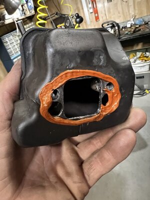

Nearing final assembly. The muffler exit is roughly 100% of the port.

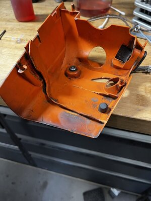

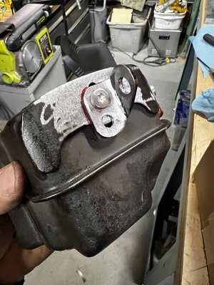

The top ended up like this. I had to trim the plastic more than I expected. Both corners of the top fins on the exhaust side were holding up the cover. I had to hack the fin where the mount bolt is and then stabilize the bolt with a bit of fuel line. It will probably melt. IMG_1965.jpeg

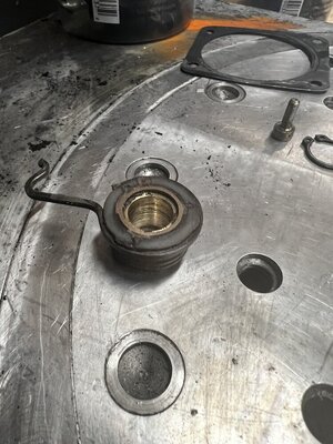

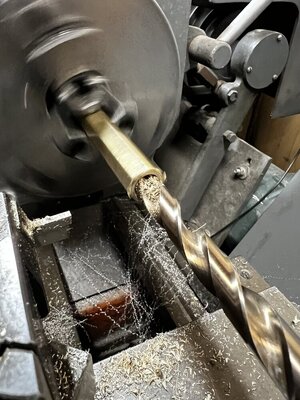

Too bad the rest of the clutch assembly wasn’t that easy. It turns out that the 440 crank is threaded an extra 2mm compared to the 361 crank. That means the clutch spins down far enough to squeeze the oil deflection washer onto the oiler gear. That would melt the gear and oil at idle. Can’t have that. Back to the lathe.
Put the clutch back on. Still too tight. Maybe…
Nope. I had to pitch it completely, only to
discover the clutch was contacting the gear itself. So…

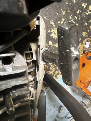

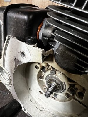

The starter side turn up a clearance issue as well. The pull housing doesn’t fit the 036 flywheel. I had to take quite a lot of the internal flanges.
Luckily I had this handy observation port to help diagnose.
The mismatch to the plastic shows how much I removed. I had to do the plastic as well.
