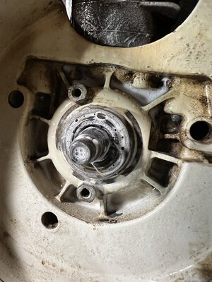

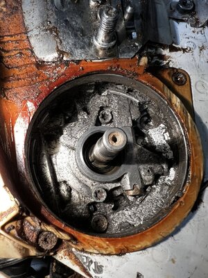

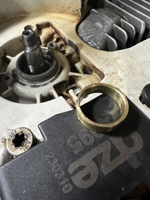

Had to re-do both seals and bushings. The FW side wasn’t tall enough, the PTO was too tall and deformed an alarming amount. I’ll try another round with brass. I may end up needing to use
steel. The oiler gear also stripped and the clutch washer came loose. Ugly in there.
steel.
I think using steel for the bushing would be better. What are you sealing the bushings to crank with? Dirko or LocTite?
