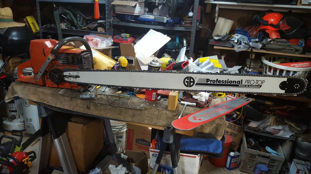

The pro top is their top of the line bar.
The CN40 is a pro top with a slightly higher hardness rating
That is the Pro Top bar.
They now make them as an Orange/Black bar which I like :)
http://www.gbforestry.com.au/store/chainsaw-products/chainsaw-bars/pro-top-bars
They only make a 28" for Husky's
