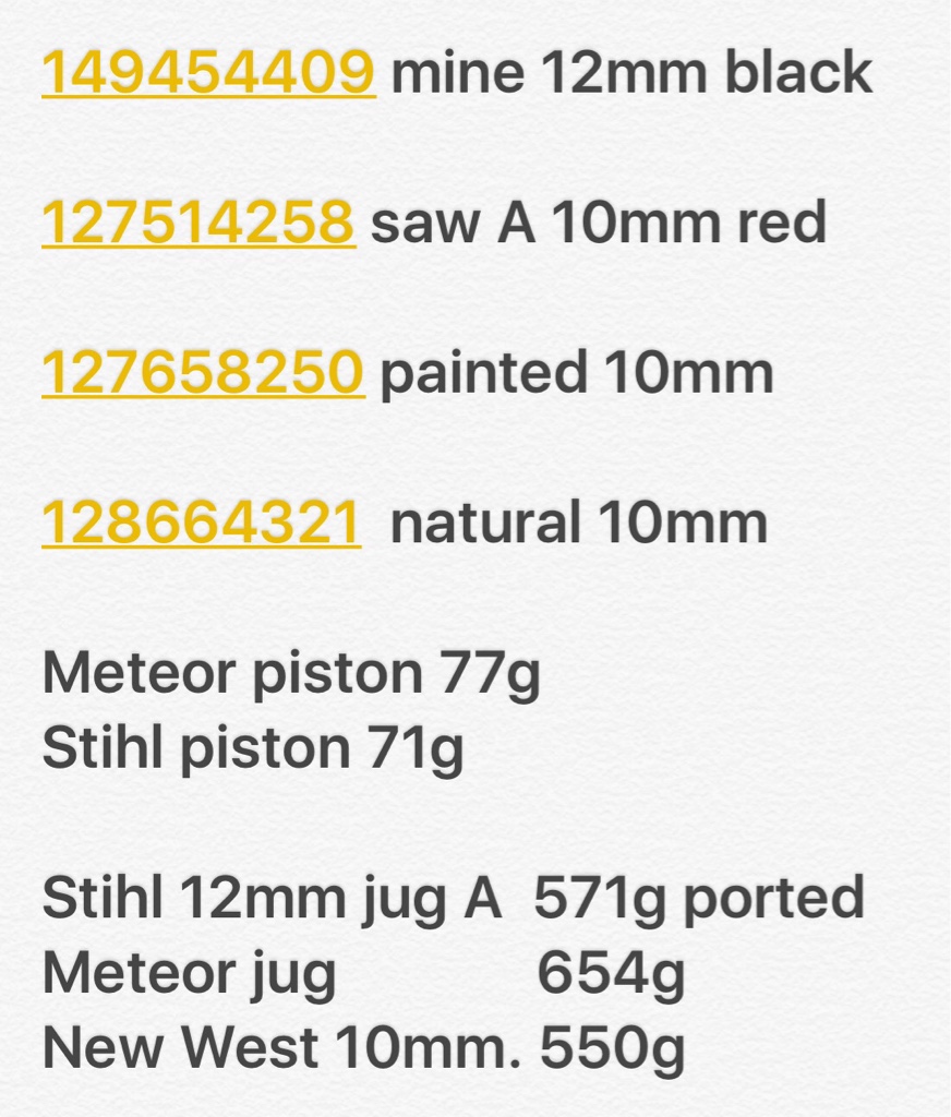

Meteor piston is gonna be WAY heavier
Wasnt that much. 9%

Just wondering why guys are still running Meteor piston kits (especially 10mm) when OEM can be had for the same price, if not cheaper?
I think the 10mm may have 12mm ring pin spacing Jeremy. So it may enable you to run a 12mm jug on a 10mm Saw. The larger intake may help more than the weight issue doesn't.
Planning on swapping an OEM piston back into my ported 10mm saw, but I'm not sure that the intake port isn't too wide already.

I plan on weighing the meteor I am putting in my brothers 044 and putting it on a weight loss program with the dremel.
If I can take 5 grams off it I will be happy
