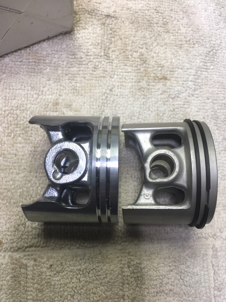

Close enough to a show pony if you ask me!!

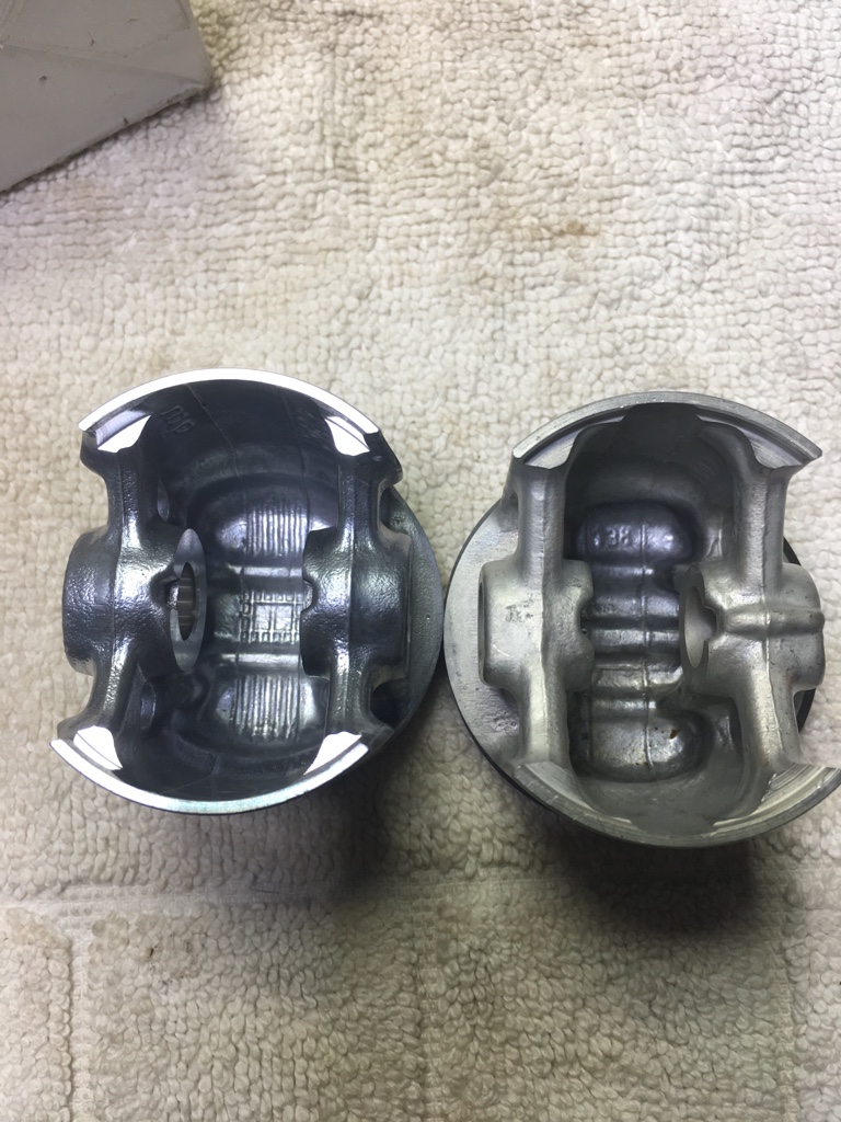

Btw. I reckon the 6 gram difference is all around the wrist pin bosses.

Yeah, I recal having a discussion about 064 pistons with Jason and he said the Meteor is a great piston but the wrist pin bosses are over done and make the piston heavy.
Looks like its the same with 044 slugs
There is also a lot of additional metal in those wings
Nothing a dremel wont fix :)
i guess they make them with bigger bosses so it can be machined to either a 10 or 12mm pin piston.

I would leave those wings on the piston. They came on the KS original pistons, and they run just great!
I hear they are to help stabilize the piston, but I would not be surprised if they also don't help air/fuel flow some how.
That is just a theory of mine, but the saw with the winged piston just runs great!
