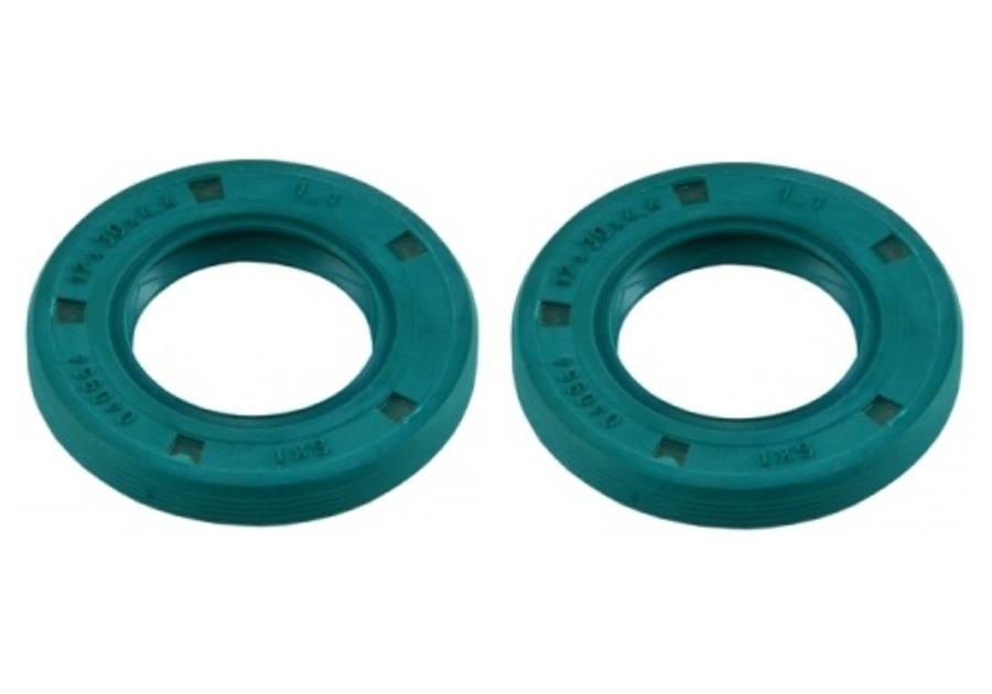

Well bad news on the vac test . Crazy thing is leaking around the oil seals. Their oem maybe I installed them wrong ..:(
5:18 PM
bummer can you put sealant around the seals? or was it leaking at the crank?
kkemp
6:18 PM
2098
Nov 8, 2016
401
676
indiana
I used sealant around them . pto side was leaking at the crank . Other side was leaking around the outside. I done a little research and I guess there's 2 different kinds ? Didn't know that . The ones I have I can change with it assembled .
kkemp
6:18 PM
2098
Nov 8, 2016
401
676
indiana
Either one should not have leaked though .
5:18 PM
How did the surface of the crank look? was just thinking of how a rear main seal on a small block chevy will wear in to the crank
kkemp
6:18 PM
2098
Nov 8, 2016
401
676
indiana
Crank looked good . At least to me .
5:18 PM
It was just a thought and you would know maybe just bad seals ?
Black Dog Chainsaw
Mak-Crazy
6:18 PM
445
Jan 8, 2016
1,059
3,125
Indianola, IA
I always use a red scotch brite pad to clean the clam shell and the crank before installing. I get the cheap green oil seals from HLS and they have never failed me ye. I run a little sealant into the area where the oil seals and clams meet but not around the whole oil seal. The green ones have 4-6 ridges on the outside to help seal it so no reason for sealant.
FYI these are on sale for $1.34/pair right now.
