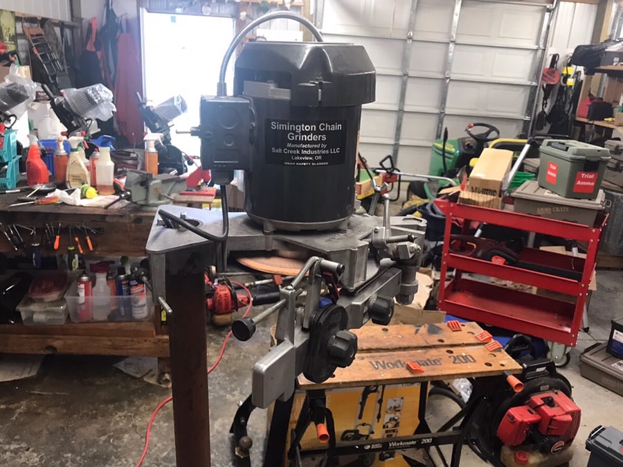

I ended up milling the box off, boring the hole out and mounting a motor like the new simingtons have on it.
View attachment 183552 View attachment 183553 View attachment 183554
Thanks for the response as well as the pictures, that looks great.
I may just rob the arm if it's the same for the 450.
Pictures (and distance taken) make things look small or large many times.
They do.
This one is waaaaay smaller than the one on my 450, it's apparent why they call it the beer can motor.

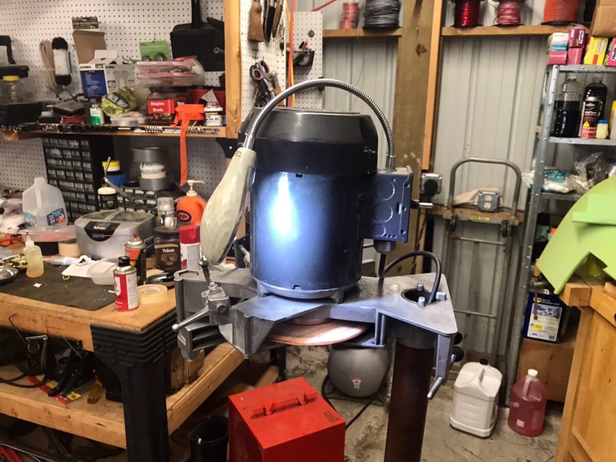

Found a used 451C.
Now to learn how to use it.
Will make a trip to Madsens soon to get some grinding wheels.

Congrats, the wheel on there now is a soft one. I have a preference for the blue to touch up after use, or white for bringing back to a good edge from abusive use. With a little reading here, and practice you may wonder how you got by without it.

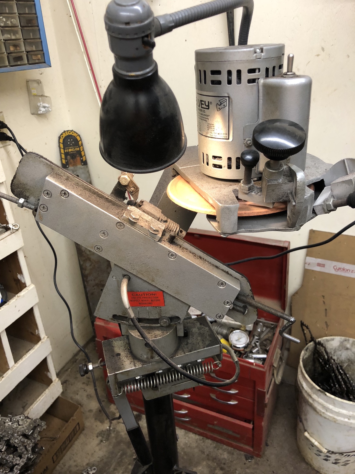

I've had an RS2 close to 30 years. Bet I've not even sharpened 1/2 dozen chains on it. Never could get them ground to my satisfaction compared to square filing. (Except one time which I remember well-can picture exactly what trees on what woodlot-perfect) Reading this thread got me to dust it off and give it another try.
@Deets066 I was going to ask for a closeup of your wheel, but found one a few pages back that I will reference thanks. Ground one last night, came out looking like a bit of a race chain.
I've got a much better understanding of square ground now, between filing for so long and reading here maybe I can be more consistent with the RS2.image.jpegimage.jpegimage.jpeg
