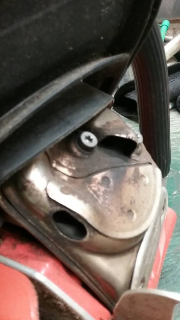

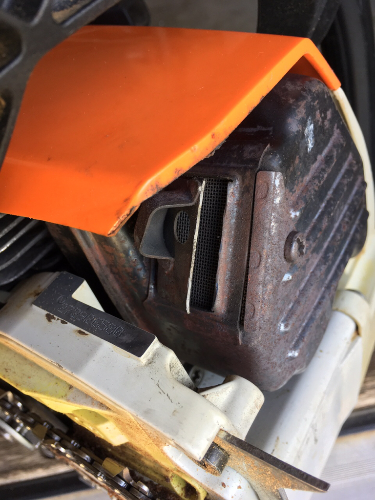

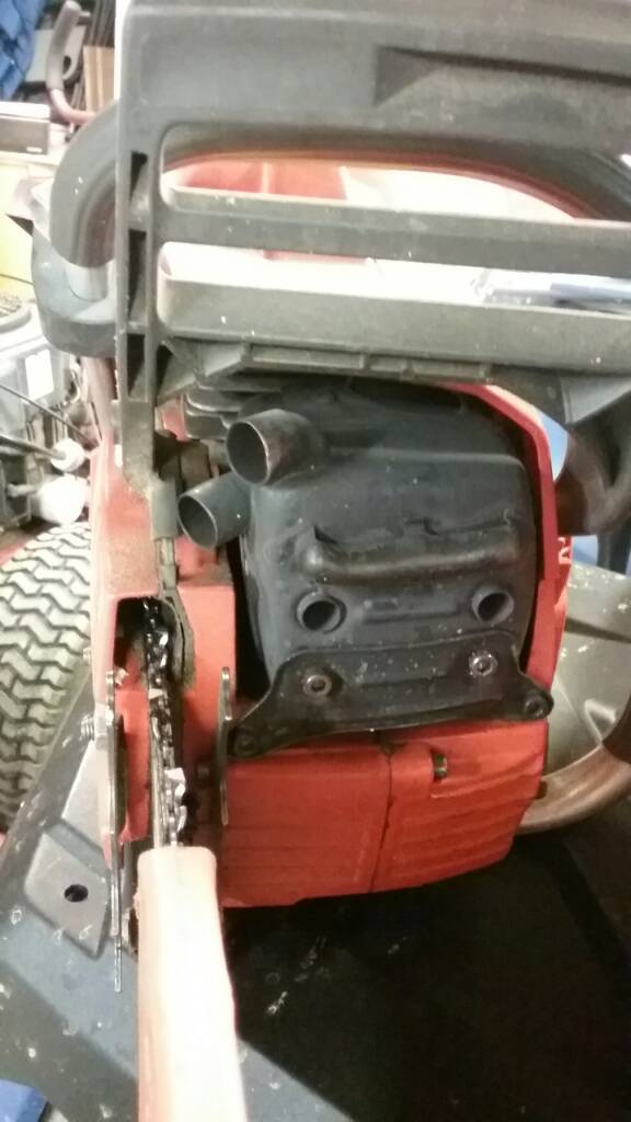

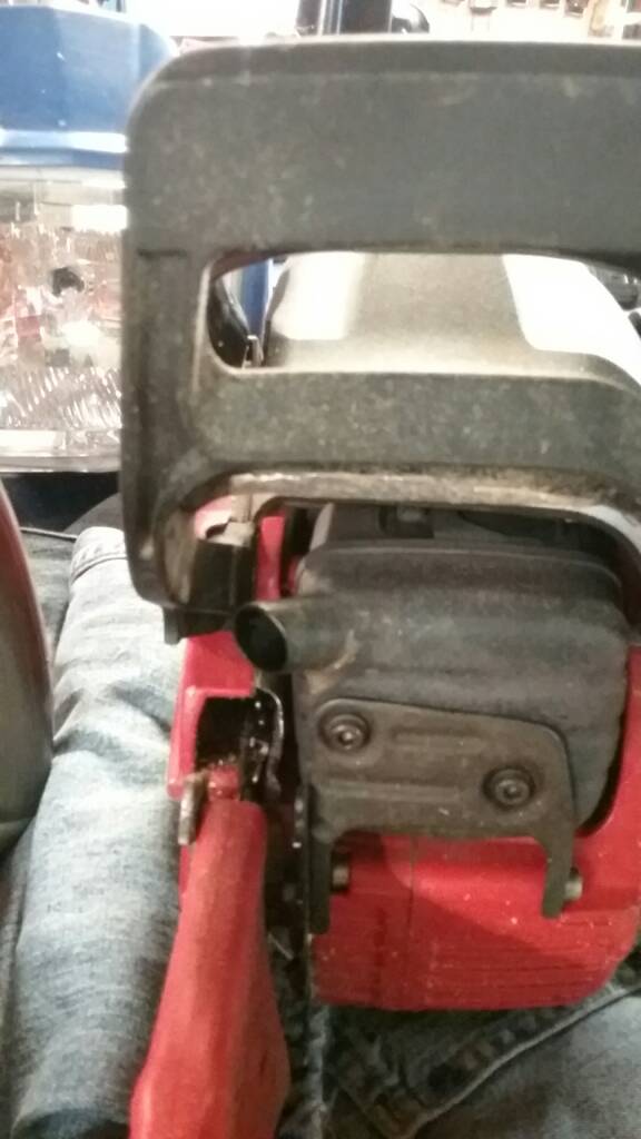

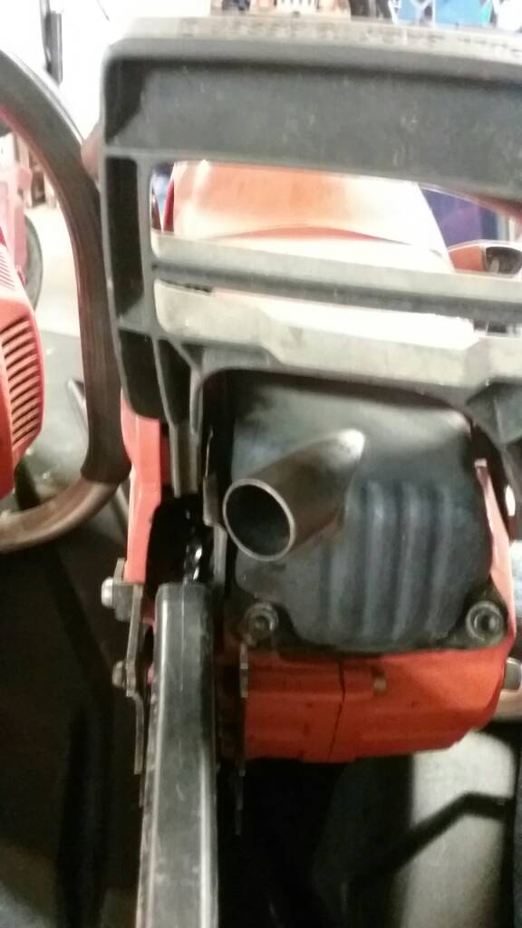

First is a 371XP with dual outlets that are brazed in copper plumbing elbows.
2nd is a 555 with a stainless pipe soldered in.
3rd one is a 2152 with catalyst gutted and electrical conduit brazed in.
4th pic is a Dolmar 5105H that was going to be too much hassle to pipe. I took out the catalyst and ground a second outlet. It sounds better and more open without much added noise, but I much prefer the throaty sound of piped mufflers.
5th pic is a Husqvarna 359 with more electrical conduit brazed.
