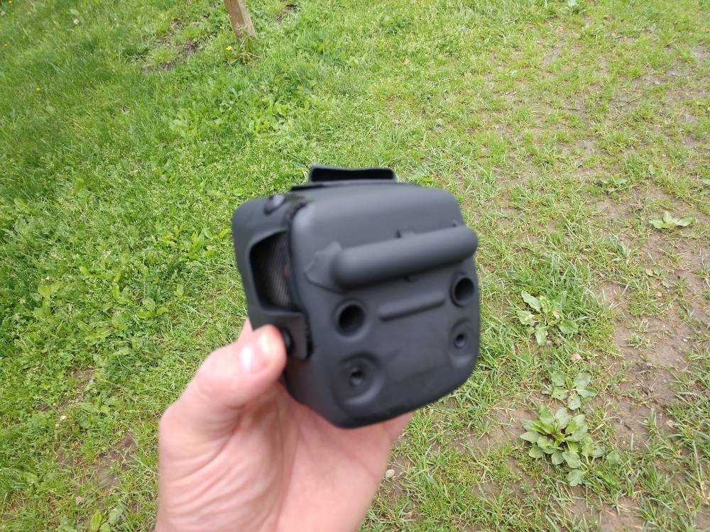

All gutted and an extra deflector must flow better. I had to open the H quite a bit for it to be happy. You can lean on it more now. I was cutting some rock hard ash and it felt like a different saw compared to stock.
The only problem was that the 500 degree caliper paint I had been using must have been too old. The finish pebbled and while the paint was completly dry, all of the dust settled on it and stuck like it was pine. I’ll have to wire wheel and repaint BBE2E4B8-38BF-4F27-A868-A8E200D66045.jpeg
The only problem was that the 500 degree caliper paint I had been using must have been too old. The finish pebbled and while the paint was completly dry, all of the dust settled on it and stuck like it was pine. I’ll have to wire wheel and repaint View attachment 184215
Rustoleum grill paint. Thank me later. FAEE1B2B-59BD-4E7C-870D-6E54A4821C55.jpeg 8900C94C-B7A9-47E2-8E7F-8B7ED4B49DC6.jpeg
