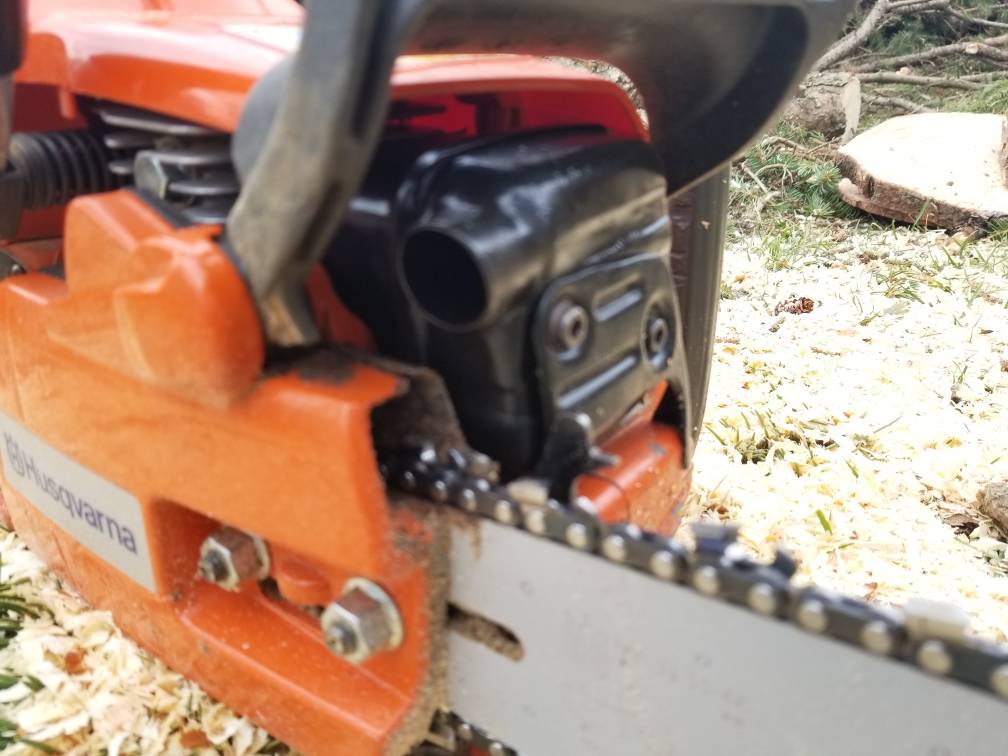

My 346 with a Kris Wagner muffler!

What I’m working on for my 346 idea taken from @Benwa
1.25” square tube body top is 1” od round then two .5” tubes at45*
What it currently has
Hard to see but it’s 1/2” I’d tube and opened up factory 27F9351E-DEFE-494B-B300-15EA8CAFA772.jpeg
Edited to add better pics
kfd518
9:20 AM
6132
May 13, 2018
804
3,338
Central Texas
Need to pull it back off and repaint it. Put it on this morning and it was going to eat the left side of the brake handle for breakfast if I ran it. Pulled it back off and put two small pieces of pipe on to make sure everything came out the front.
If I let it cut it will hold 10,800 easy , leaning on it it will get to about 9600 and stay there pulls nice and strong.
Ear ringer now for sure
