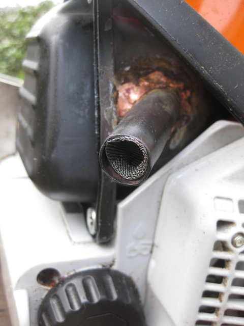

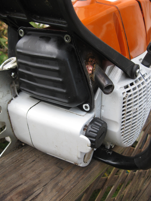

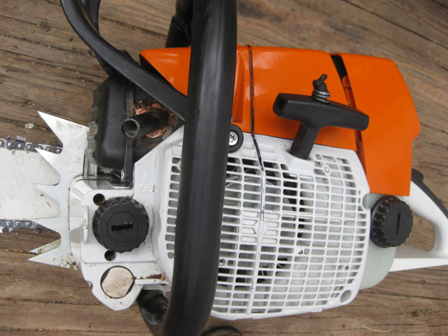

For my AM 660. Just did it today. Still needs woodstove paint. Had to test it...
My saw, which is fairly new, was running pretty fat as it was. (I bought it on ebay from a builder in B.C.) After burning about 1.5 gallons of mix, I leaned it out to get about 11,500 rpms (still 4-stroking at WOT) and left it there to play it safe. With the new exhaust, I didn't really need to fatten it up at all ... it still 4-strokes at WOT, though I didn't check what RPM I'm getting at WOT.
The fact that I didn't need to richen the H jet makes me wonder whether I should open up the exhaust even more...
That hole looks a little small....
