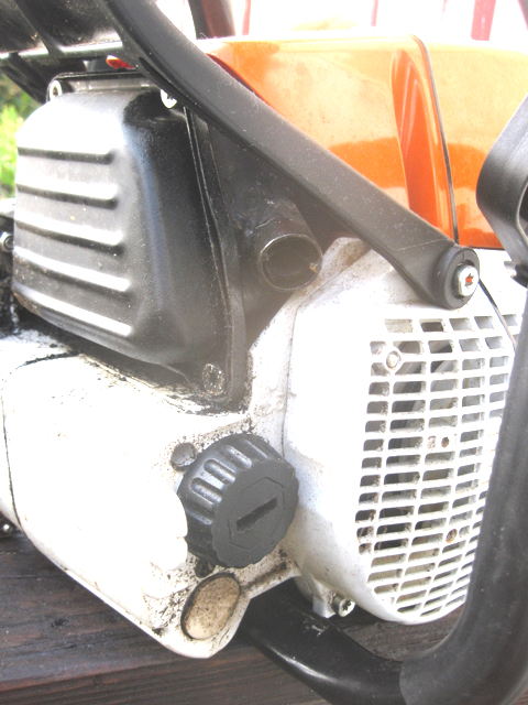

That hole looks a little small....
It's almost the same diameter as the large hole on the other side of the muffler.
Maybe I'll unbraze it and rebraze a bigger pipe in its place...if there's room...one concern was not interfering with the brake lever...

Well, I un-brazed and re-brazed a bigger piece of steel tubing on my 660.
Also tigged on a "V" shaped piece of silicon bronze filler to hold a cone of stainless steel screen inside...
Exhaust port is about 0.944 in²
Net free area on muffler is now about 0.703 in² which works out to about 74% of the port area. Runs stronger and burns more gas.
