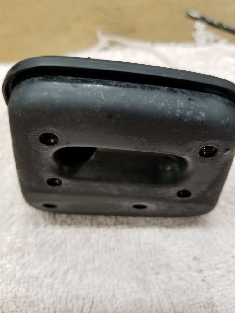

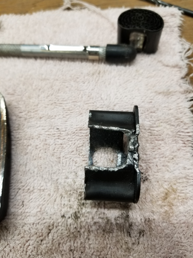

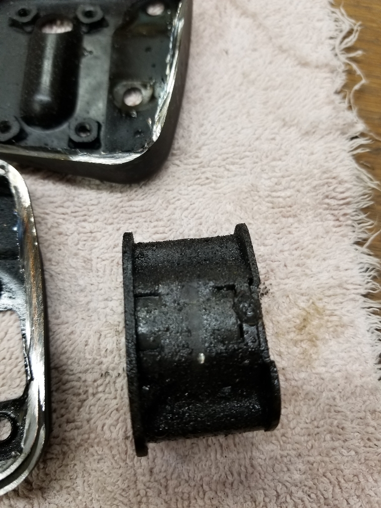

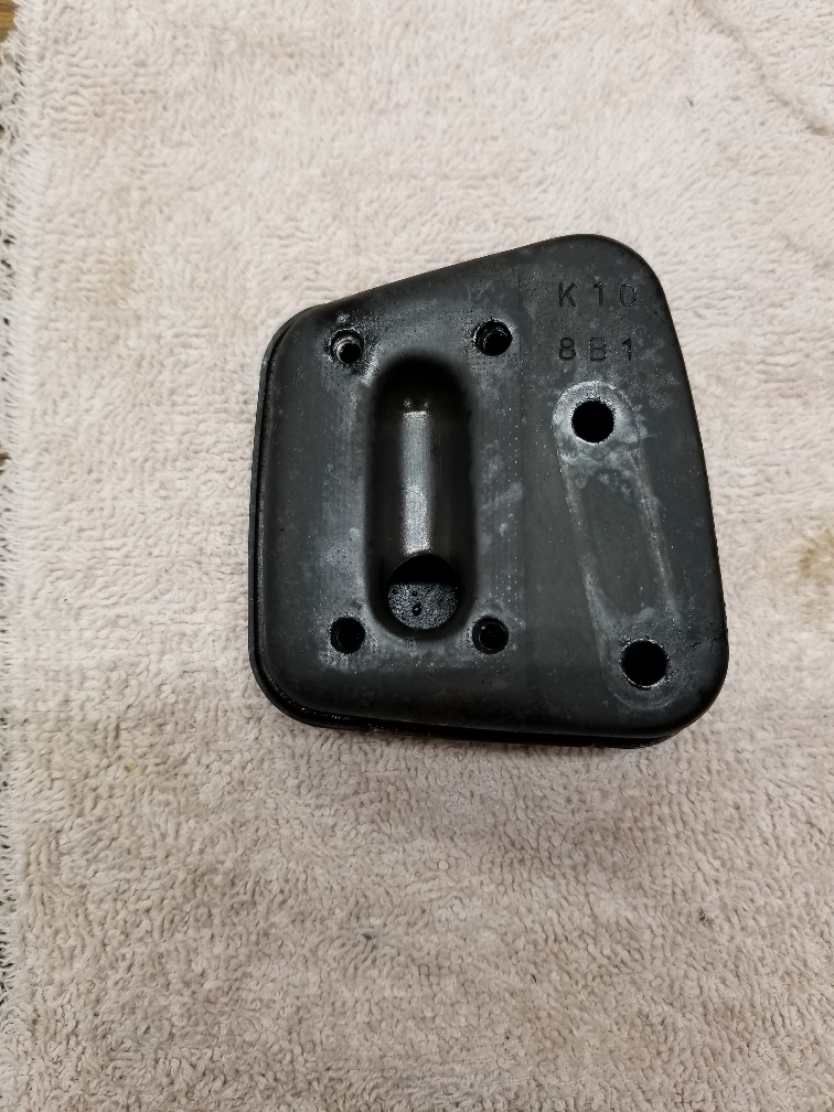

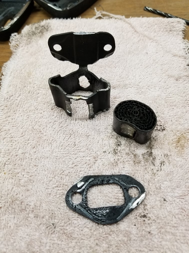

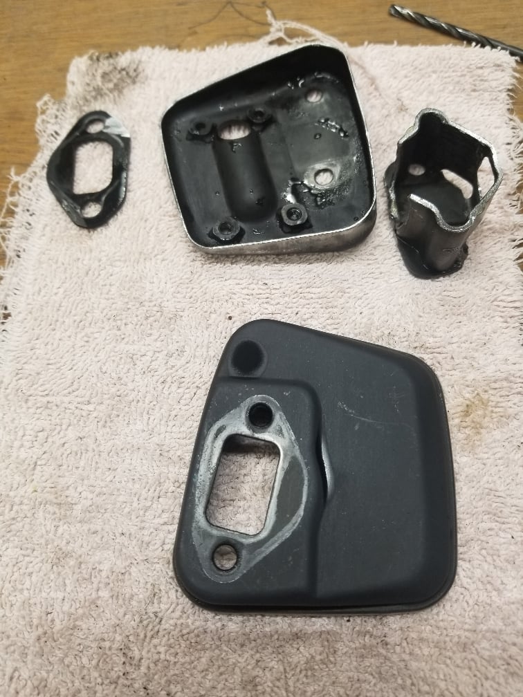

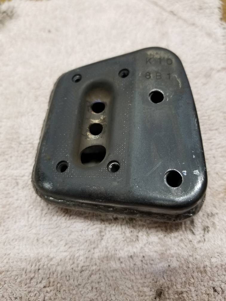

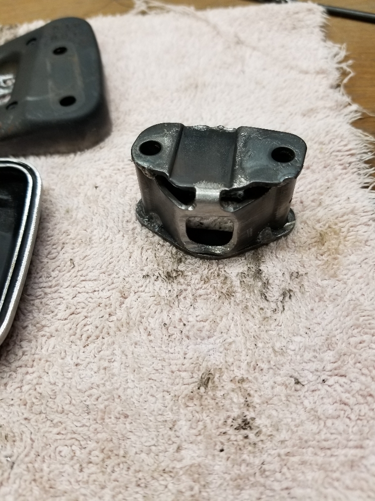

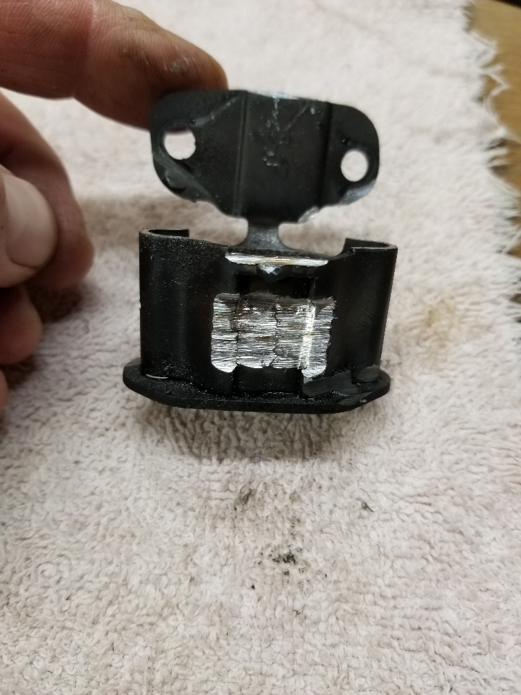

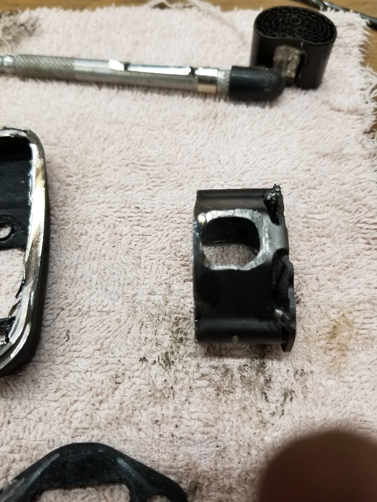

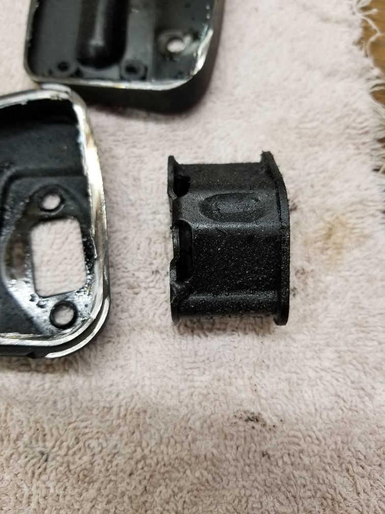

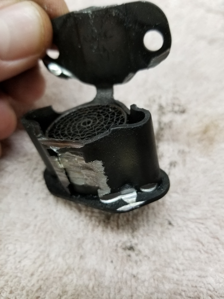

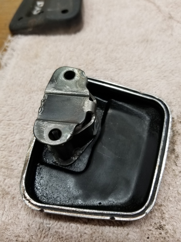

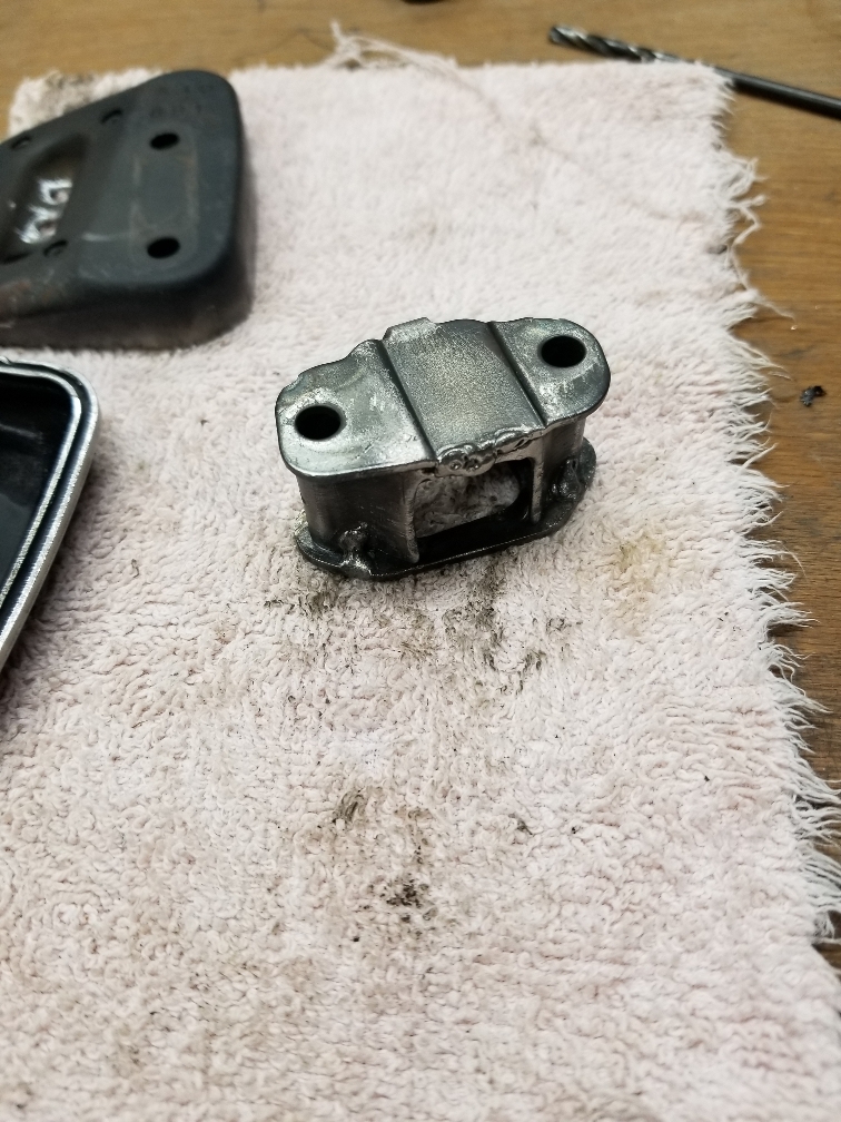

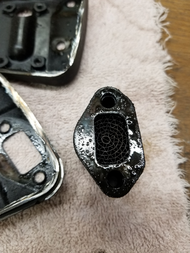

I just did a 6100 muffler, so I’ll include the baffle that was in there too.

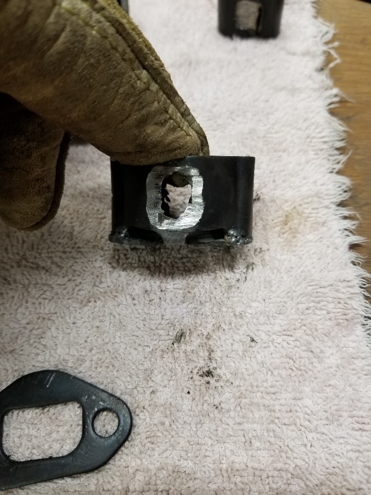

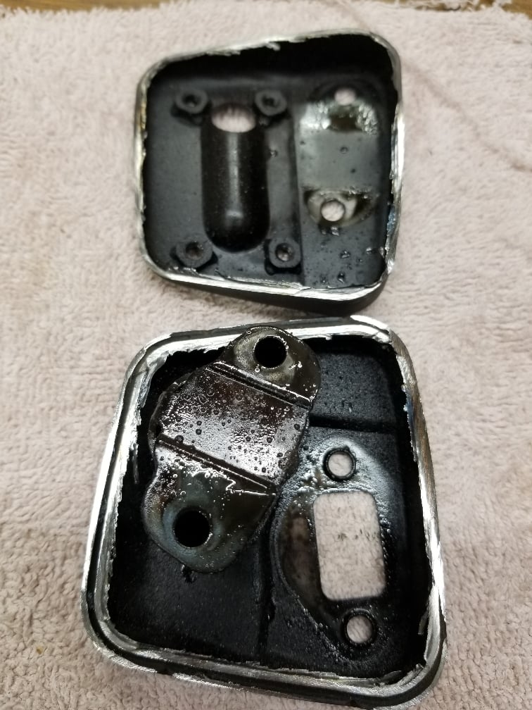

Did this echo 360t awhile back, I should have weighed it before and after. Took alot out

@Mkinslow
Next time throw all that *s-word inside away. Use the plate or plates and some tubing for spacer blocks. Way faster, better and much easier. Even square tubing is better than all that fab work. The only thing you need to weld is the ends to tack it and the can seem.

@Mkinslow
That's what I was going to do but I didn't have anything small enough on hand. It really wasn't to bad to do it this way. I'd guess it was 15 minutes to grind away the spot welds. But yes tubing was my first thought and would have been better.

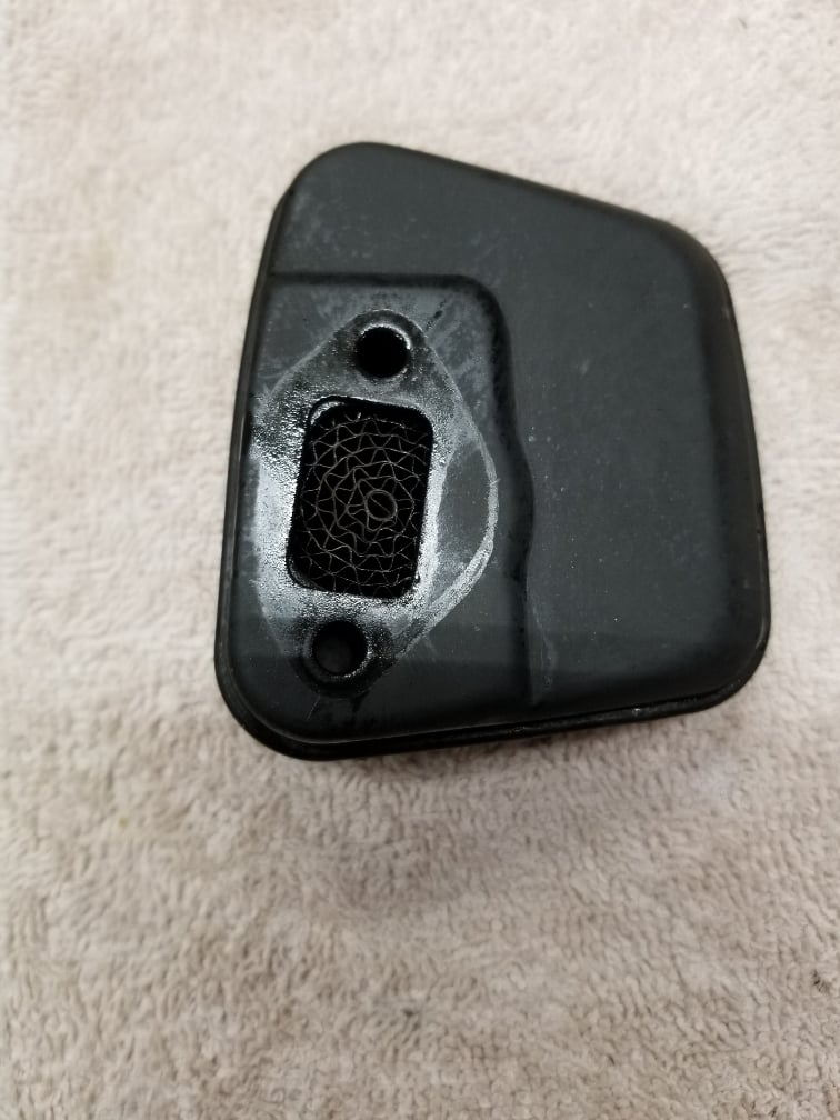

Finished, welded back together. Thickest metal on a muffler I've ever messed with. Drilled 2 more ⁵/¹⁶ holes and used factory deflector to retain screen.
On the last 360 I did, I ground out the cat, and then I just drilled a big hole in the baffle/flange the cat was attached to. It took forever. So it basically dumped the exhaust straight out the muffler, and I didn't have to bother cutting the entire thing in half. I also removed that entire area you drilled 3 holes in to and matched it to the cover. I then cut the cover so it had two exits.
